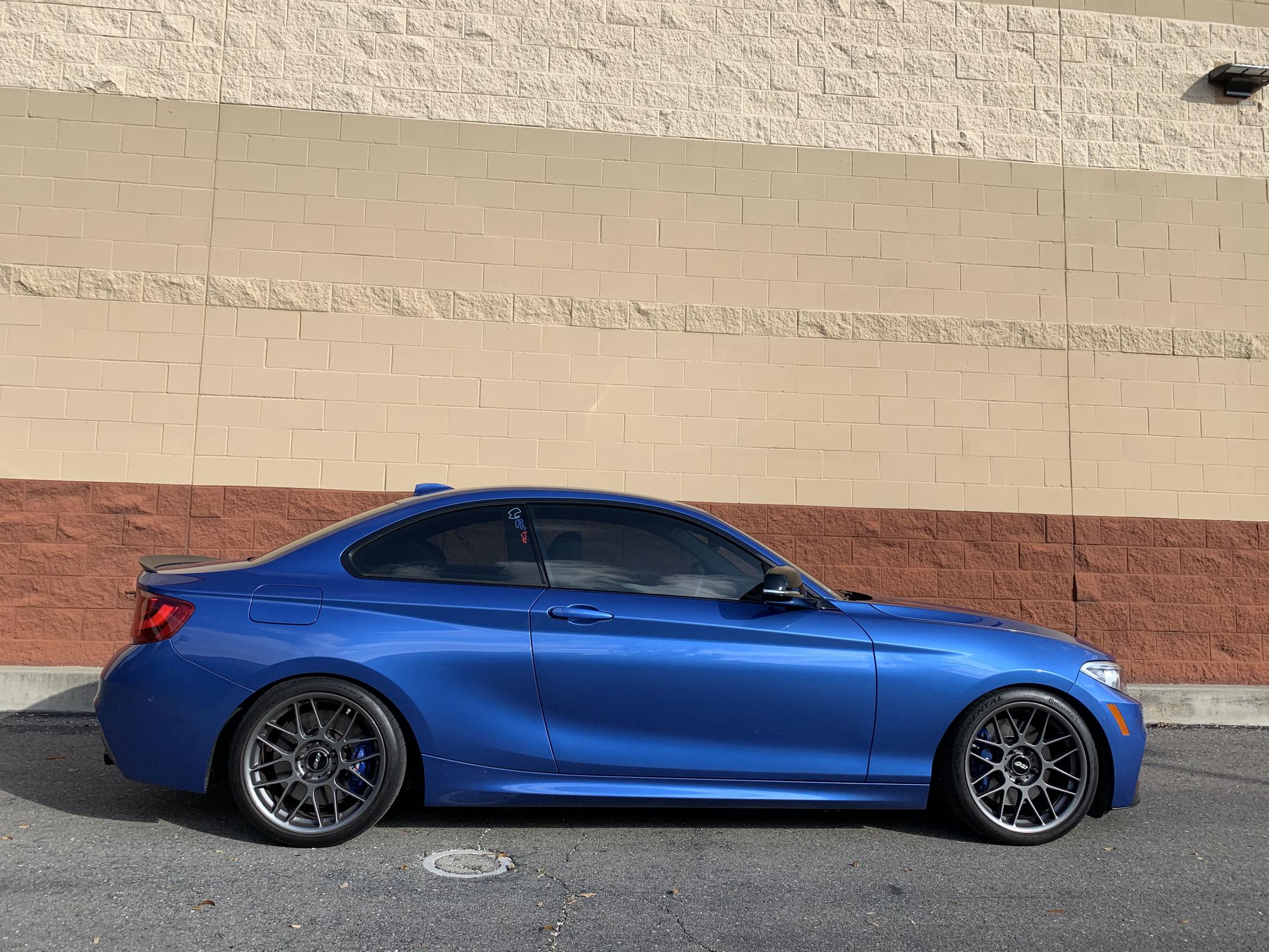

Got some Apex EC-7s yesterday, digging this new setup
18x8.5 ET45 with 5mm spacer, 235/40/18
18x9.5 ET58 with 5mm spacer, 265/35/18
Tires are Bridgestone S04 Pole Positions, they seem to run wide but the 5mm spacer gives me just enough room to clear the shocks
Appreciate 5

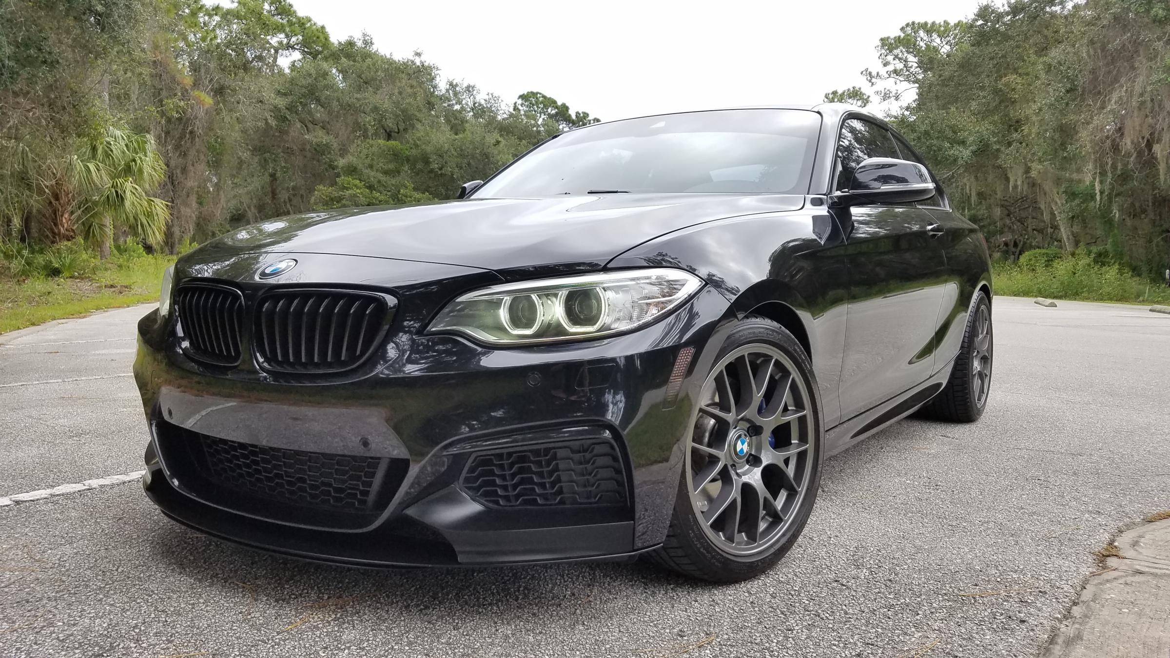

Here's mine with EC-7s in anthracite with Michelin A/S 3+:
Front: 18x8.5" ET45, 5mm spacer, 235/40
Rear: 18x9.5" ET58, 5mm spacer, 265/35

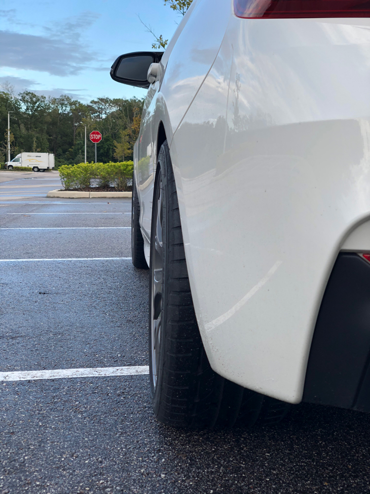

2015 228i  [0.00]
Not my first bimmer but my first to wear Apex-es
FL-5 18x8.5 ET35 square wrapped in 235/45 MPS4S.
I am running Dinan springs and the fronts rub the fender lip just slightly under rapid compression, but it occurs so infrequently it's no biggie for me.
