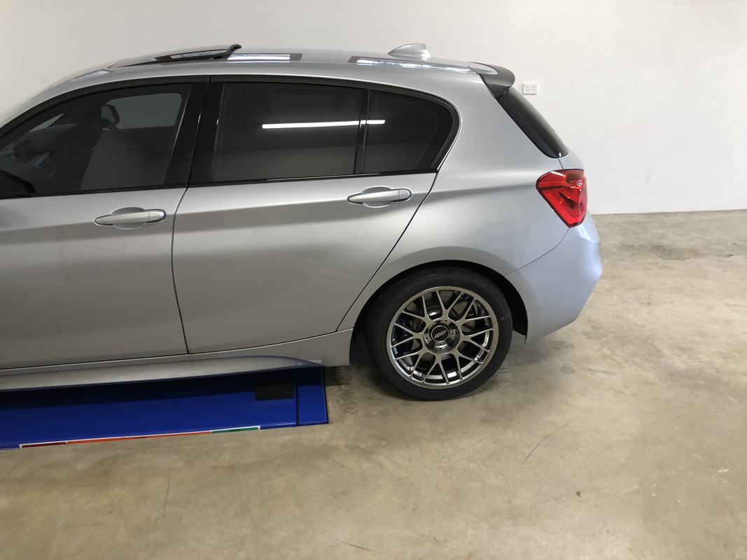

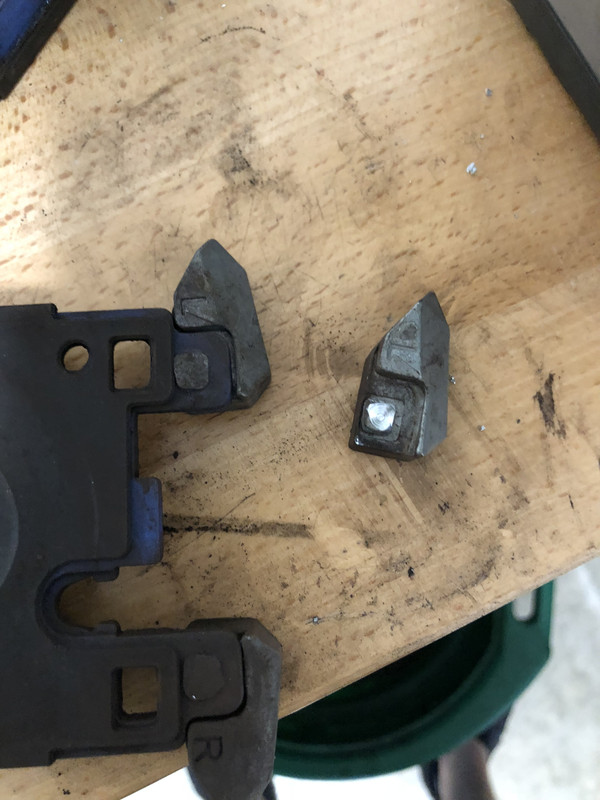

17x9et42 Arc8s hit the vibration damper weights on the rear brake pads.
But if you knock them off (or have track pads that don't have them) then they will fit.
The front needed a 5mm spacer.

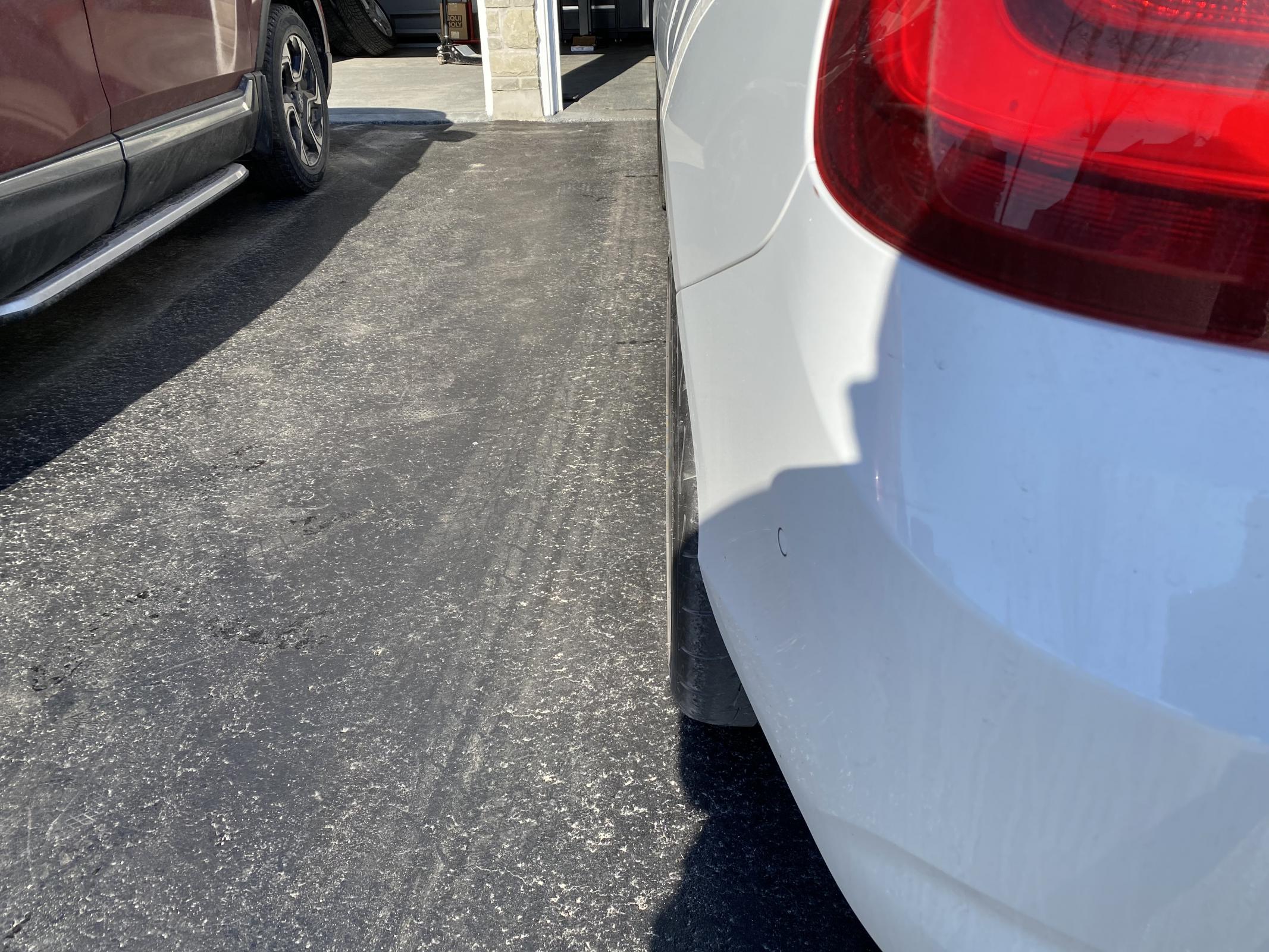

235/40/18 and 275/35/18 on 228i xdrive
Decided to try my 18x8.5 et45 / 18x9.5 et62 Apex Arc-8s out on my F22. They fit great with my stock suspension. No rubs at all yet and fitment looks great IMHO.
Tires are Firestone Firehawk Indy 500 which run a little narrow so I think that's how I got the 275s to fit. Running 5mm spacer on rear so effectively have an et57 offset.
This set is off my 1er.
Update - 11MAR20 - Been using it for a few days now with mixed driving. Not a single rub yet
