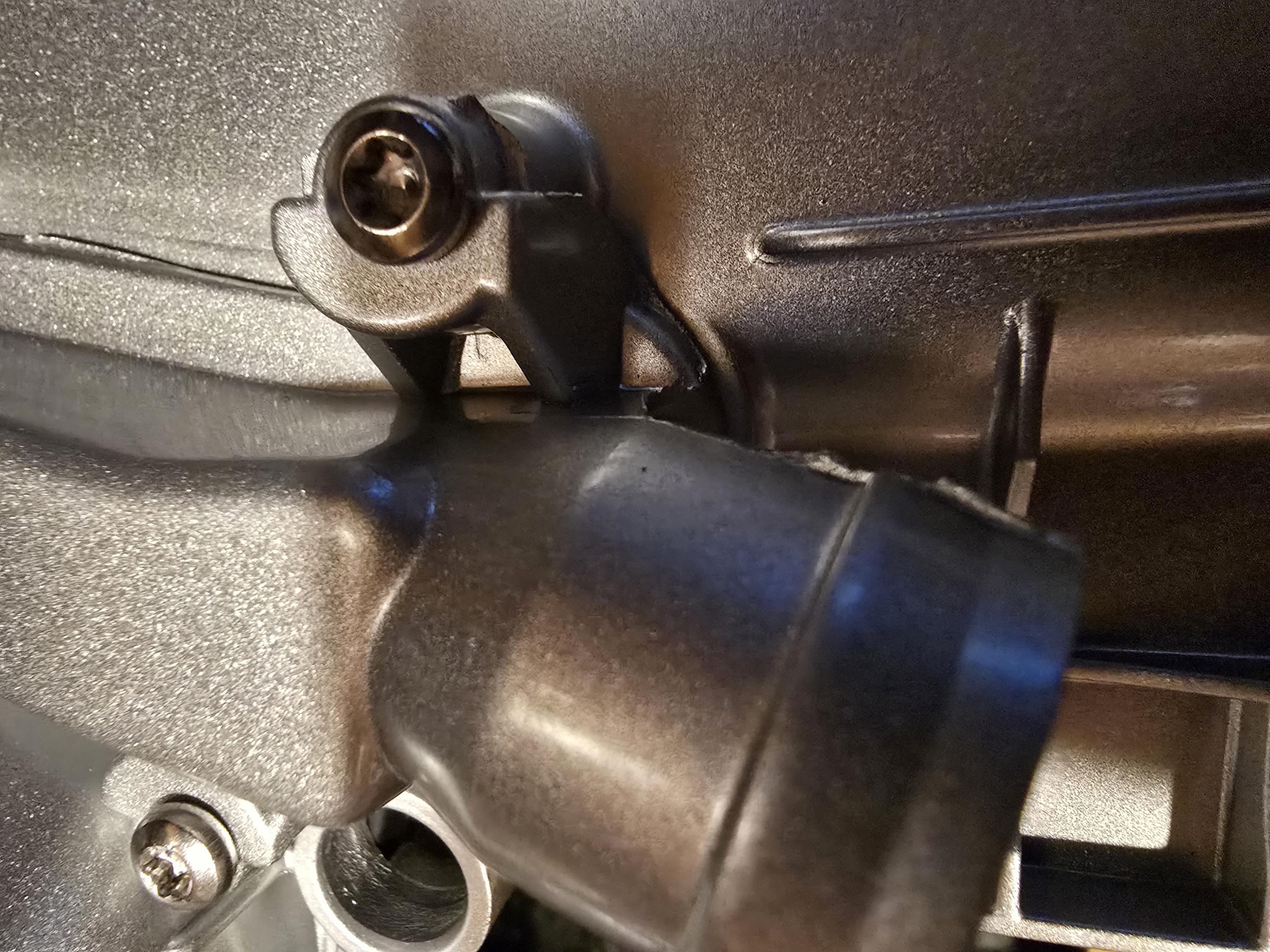

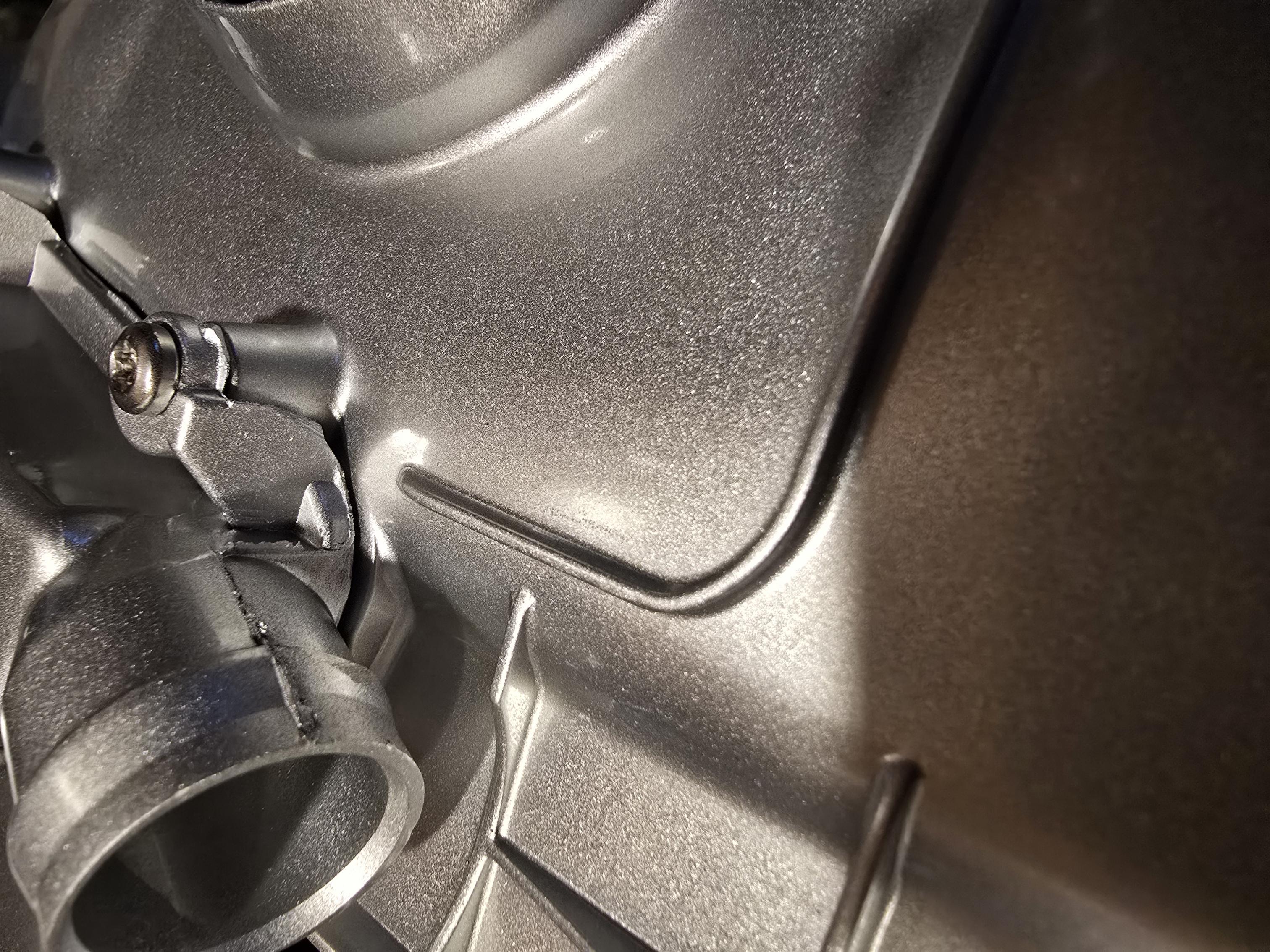

I am in the same boat my 235 just turned 80k started to notice a bit of a burning oil smell the other day and figured it was time. I had been researching for quite some time all the valve covers ad reading reviews. Noting that it seemed to be pretty even on complaints across all the aftermarket OE plastic type or the aluminum for having continued leaking or failure shortly after install and some seeming to have no probles. None seemed to be problem free even the bmw ones. So the best conclusion i could come up with was pick the best in your price range do a good prep of all surfaces be very careful reinstalling not to roll the gasket and hope for the best. I purchased an aluminum one from ESC due to the offer of a lifetime warranty. I will check to see how true it is prior to install and hope for the best I might go the extra mile and pop the pcv make sure it seated correctly and possibly and a little gasket maker to the mating surfaces for a better seal. I did pick up a inexpensive smoke machine to di a pre and post install to check for leaks that should be a fun experiment. Keep us posted on what route you go with and how things turn out.
Aluminum cover just arrived will see how it goes over all it needed a little clean up nothing a small file couldn't fix

Not trying to hijack this thread but since the question was asked instead of starting an new thread. Here is the aluminum cover installed from ECS Tuning. I did as smoke test to look for vacuum leaks and didn't find any. The car idles dead on no missing/stumbling. I am now getting and intermittent code of 101F01 that states air mass system playsibility calculated air masses in air intake system not plausible. Anyone have an idea ? I did replave the pipe going from the valve cover to the intake and even swapped back the original with no effect
