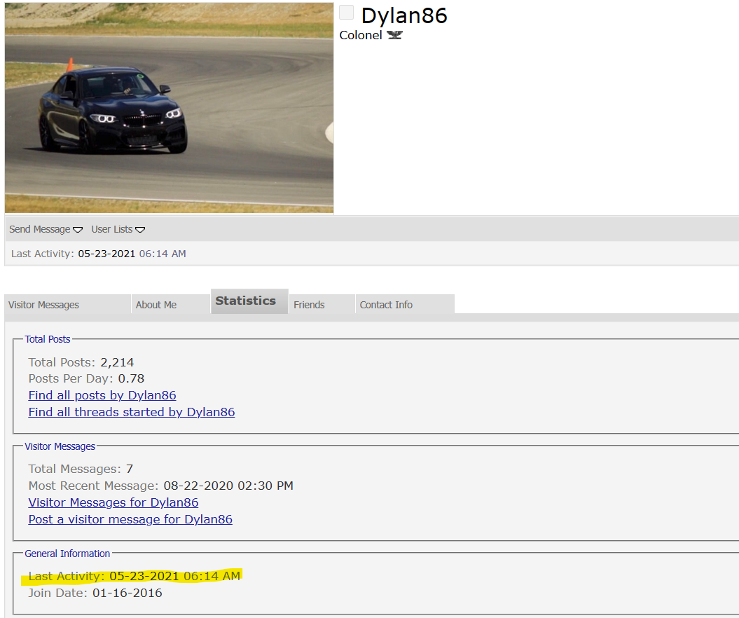

3690
6,171
OP, are you still with us?
Mods: Yes.
Originally Posted by umizoomi View Post
As long 3-pedals are an option, I will exercise my right to suffer the handicap and indignity of slower shifts and reaction times.
      10-26-2023, 07:28 PM   #149
harma24
413
763
Drives: 2017 M240i Glacier Silver
Join Date: Sep 2016
Location: 19.5mi NNW of Boston, MA
The OP hasn't been around for more than two years...
