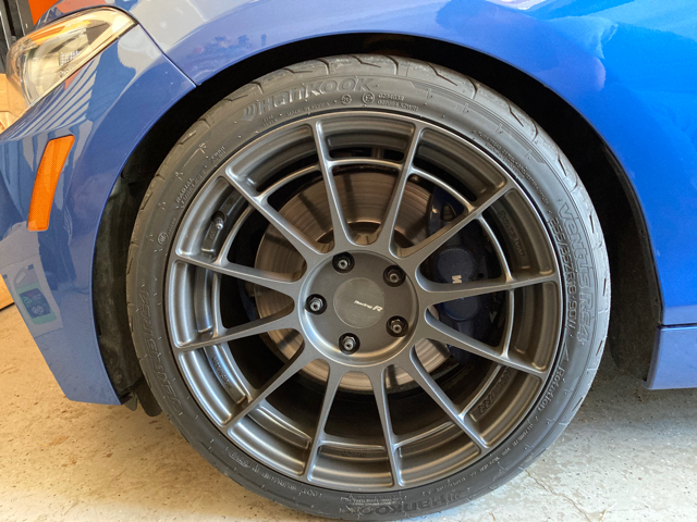

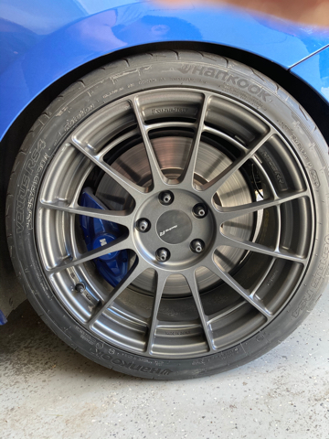

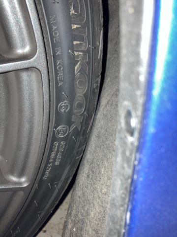

Forgot to take pictures when I was out. No rubbing. I figured mine out by talking to OP.
note: Xdrive with no m3/m4 LCA, hence more clearance.

Looking good brother, glad I could help you along the way!

PS - I tried to take as many random angles possible of the wheel fitment, as it seems not many have done the Front: et42 9.0" or Rear: et43 9.5" from Apex on the F22. It fits, PERFECTLY! A 255 would allow a bit more clearance out back and reduced camber (-1.8* to -2.0 vs -2.1* minimum imo), and 245 would net the same savings out front with a dial back to -2.8*.
First off, amazing build! Gain so much good information from your thread.
Are your APEX EC-7 9.5 ET43 in the rear really perfect? The APEX reps and a few guys have said it pokes and they all suggest 9.5 ET58 with 5mm spacers. Everyone seems to be scared to run ET43, except for you.
Just a short background, I am on Dinan Springs and I do plan on tracking (first timer) the car with the correct alignment, probably 2.25° in the rear based off quick research. I would prefer going ET43 in the rear to avoid using any spacers and have a slightly more "aggressive" stance/setup. I've also read, for each degree of camber, the wheel should be tucked about 4mm or so, any truth to that? Therefore, by running your exact set up and -2.25° camber, I shouldn't have any clearance issues right?
I'll probably run 255/40 RE71r to be safe first, unless you're confident I can clear 265 with ease.
I also never even considered running 18x9 ET42 on the front as I never seen anyone run that spec before. Any huge advantage running 9 ET42 instead of 8.5 ET 35 on the fronts? Trying to get close to square as possible maybe?

Thanks for the kind words, sir! It's been a great journey and still growing as I go.
In terms of fitment on the rear, Apex did advise that it'll be very close and to plan to run a 255 max without a fender pull. I installed them as is with 265 RE's and -2.2* camber and it only rubbed on big compressions and I'm also a bit lower in the rear than a Dinan spring drop so it may be a non issue. I've recommended this setup before with a 255, I think it'd be perfect. With a fender pull you'll get 265's in there no sweat.
The front 9" et42 was also recommended by Apex as a max width for the front. I was going to run 9" square but wanted to get more tire in the rear so I went with the staggered setup. With 265/9.5 and 255/9" the contact patch with the RE's is very similar, it drives very square.
I would consider 18x9 et42 square with 255's. You'll require minimum -2.5* camber up front so camber plates are a definite must. Otherwise you're either forced to go staggered or have a super aggressive 9.5" square set which would require even more finking.
Hope that makes sense
