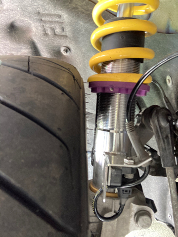

Got some things accomplished last night. *PS* the underbody is dirty, I just drove across the country, usually I detail it once/month so no comments about the filthy underside, please
Here's the clearance for the coilover/tire with the 18x9 et42 and 255/35 RE71R (they run wider than most). A 245 would take 1-2mm away, and an 8mm spacer, another 2mm, which would be ideal for the 9" wheel IMO, or a 235/40.. When I go 9.5", I'll still most likely run 255's, but square.

First of all, I love your build!
I wanted to ask you a few questions about your wheel fitment, specially in the front. I got a set of Potenza S007A in 235/40r18s and Id like to run them in a square configuration with either a 18x9 ARC-8s or EC-7s in an et42 like yourself, I’m not planning to track the car and my suspension is stock. I know a lot of people run the 18x8.5s in either in an et35 or an et45 (with maybe a 3mm front spacer, that turns that et45 wheel to a et42), this seems to be a fairly common Fitment for the f22s; However, I like the 18x9 rim because it does have a slightly different profile look than the 18x8.5 version of the same wheel.
My question is in regards what you think would be the minimal front spacer size needed to clear the front strut with a 235/40r18 tire, given that this tire is roughly 3/4” narrower than the 255s you’re running, also how much camber do you think will be needed with the narrower tire. Thank you.
      05-16-2020, 01:29 PM   #90
1339
My question is in regards what you think would be the minimal front spacer size that Could be used to clear the front strut with a 235/40r18, given that this tire is roughly 3/4” narrower than the 255s you’re running, also how much camber do you think will be needed with the narrower tire. Thank you.
Hey man! Thanks for the love
Apex always recommends the 10mm spacer on the et42 9" setup. This allows for the inner clearance to the strut. I'm not sure on stock struts exactly how the fitment is, inside, but if using a 235 tire on that setup on stock suspension I think you'd be just fine with the 10mm spacer. The reason I'm opting for a 7.5-8mm spacer is because I've created a bit more clearance inside by installing a shorter coil spring which allows the perch to raise high enough to help (as pictured). Without the shorter spring on my setup, the tire would be much closer to the perch.
Apex always recommends the 10mm spacer on the et42 9" setup. This allows for the inner clearance to the strut. I'm not sure on stock struts exactly how the fitment is, inside, but if using a 235 tire on that setup on stock suspension I think you'd be just fine. The reason I'm opting for a 7.5-8mm spacer is because I've created a bit more clearance inside by installing a shorter coil spring which allows the perch to raise high enough to help (as pictured). Without the shorter spring on my setup, the tire would be much closer to the perch.
D
I see what you mean, basically it’s not just the strut, but also the spring perch clearance that comes into play with the wider tire. I think i might buy 3mm and 5mm spacers when I get the wheels and then go from there.
Im trying to keep the tire away from the fender as much as posible, worse case I’ll roll them a little. Thanks for the help. Btw, I love the color contrast between the yellow calipers and the black paint.
If you can get away with a smaller spacer then that's definitely the way to go. Without added negative camber that would be best, otherwise if you can reach -2.0 using M4 LCA's or camber plates then you can clear the fender no problem with 235's even with the 10mm spacer.
From Apex
"Front & Rear: 17x9" ET42 with 255/40-17 tires •Available in ARC-8, ARC-8R, and EC-7R designs.
•Front 8mm or 10mm front spacers required (hub extender required). 12mm can also work with negative camber dialed in.
•Rear negative camber and/or rolled fenders highly recommended"
