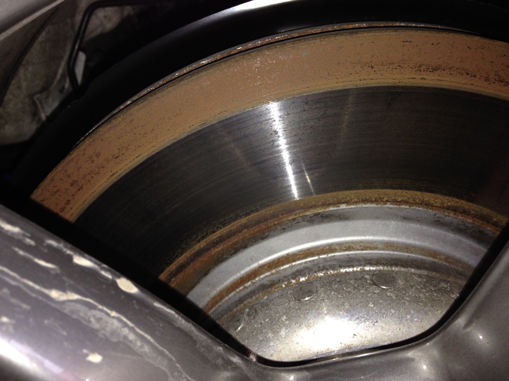

So I'm bumping up this old thread of mine, even though another similar one has been active in the meantime... This time, I'm rather seriously worried though
True - my car has spent the winter mostly sitting in the garage. Not because of to much snow, too cold or anything weather-related; I just didn't have to drive but instead was very busy (I'm working from my home office). Some 2 weeks ago I gave my car a good wash, and - after just a short trip - put it to the garage again. Today I started the engine normally, put the car on R, and released the brake pedal...
Nothing. The car was stationary. I stopped the engine and started it again; tried to reverse from the garage: still no move...
I got nervous, as I had a business appointment. Restarted the engine again, and this time not only released the brakes (while in reverse), but also pressed the gas pedal slightly. It felt like the car wanted to move, but was blocked by something... So I decided to press the gas harder - and after a loud "bang", it reversed normally as if nothing was wrong!
No error codes, nothing. Only my rotors look more rusty than ever... Could it be my handbrake getting stuck on the rear rotors?
Scary... What do you think guys?

Mine does this from time to time. I can only assume but I'm thinking that the E brake gets seized slightly and needs some encouragement to release. My driveway is sloped a bit so it gets some help from gravity when I'm trying to back out. I have the MT and sometimes when I release the E brake in N the car doesn't move. I can usually rock back and forth in my seat and it will brake free and start rolling back. I wouldn't worry too much about it.
Mostly happens if I wash the car in the driveway and then let it sit for a while, drying the brake dust residue onto the brake pad and rotor.

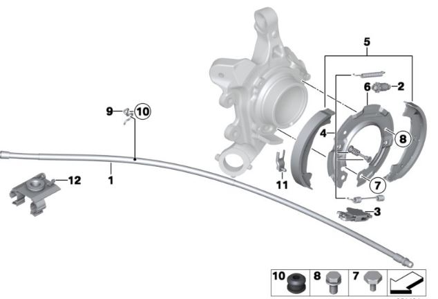

So - considering how the emergency/parking brake operates on rear wheels in the 2 series - can someone explain why, when it's seized like this, it blocks the wheels' reverse movement more than it does their forward rotation? If you help me understand this, I will rest assured there is nothing to worry about (I hope nothing was/is wrong with the AT/torque converter as no error light went up, and there are no warnings in iDrive vehicle status)... Cheers,
Piotr
PS. One other thing (not so much worrying but making me wonder): as I said, my car did have several long periods of not being used at all during this winter (I only use it for long trips, and it so happened I had less than usual need for them lately). The car was sitting in the garage for several days and not always clean between those rare trips, and yet no rust developed on the brake rotors (true - the temperature was well below freezing most of the time). But after the wash, even though the car wasn't used for a much shorter time - I'm having the rotors severely rusted now...
PPS Here is the link to the parking brake parts (inside rear wheels):
http://www.realoem.com/bmw/enUS/show...diagId=34_1972 . As can be seen, this indeed is a very traditional mechanical brake with shoes, acting inside an additional drum; does it explain a possibility of complete seizure of only reversing rotation of the wheels?

Not an issue at all. I get this brake "pop" all the time after washing the car and immediately parking it for a day+. The rotors have a lot of iron in them and the rust builds up and binds to the performance brake pads. Breaking of the buildup is what results in the pop you hear. The issue isn't with the ebrake as it's located inside the rotor hub. No water is getting there.

But in a post before yours, it's been stated it isn't the parking brake's shoes inside the rotor hub, but the rotors binding with the main brake pads with rust... Also, even the manual (not to mention my experience with previous cars using this kind of parking brake) suggest one should use the parking brake as often as possible, or the linkage and all other moving parts will corrode, get dirt etc. resulting in the whole mechanism losing effectiveness... And when are we supposed to use the parking brake "often", if not during actually parking the car? Plus, how often do we park it on a sloppy surface?
Considering all the above, I guess I've developed a habit (almost a unconditioned reflex) to engage parking brake when storing the car in my garage...
On another note: the rotors are so badly rusted after I stored my M235i for several days after washing it that I wonder whether they gonna shine again just after normal brake usage over several hundred kilometers, or if I should disassemble, clean and perhaps even grind/polish them...

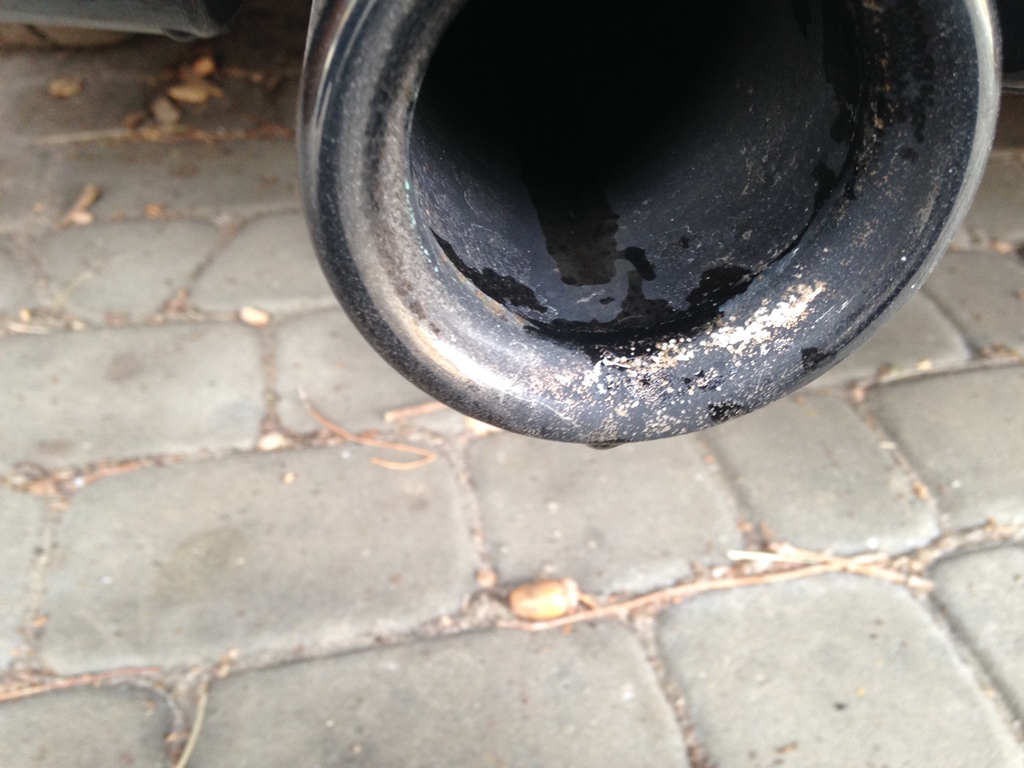

So, probably all of us witnessed BMW's rotors rusting after a couple of days not driving it and storing in a humid place, or in the rain. All this have never posed a problem to me, as it's always been enough to drive (and brake) the car normally for a couple of kms.... Not this time, though - just look at how my rotors corroded: the surface that the pads act upon is already almost clean, but I can't see how the rest of it (particularly at the outside rotor's perimeter) can possible get clean all by itself!!!
As my standard warranty expires in a month time, please advise whether I should push my dealer to - what? Replace the rotors? I somehow don't believe they'd do it; today had my oil service done and when I showed them my rotors, they asked "what kind of stuff I applied when washing the car lately"?
Opinions, please

PS. Speaking of rust: the other picture shows my M-package black tailpipes after just 2 years and 25k km...
