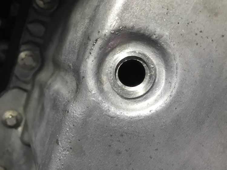

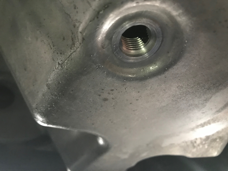

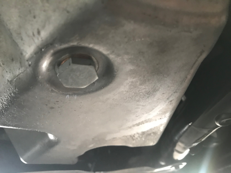

Please help, N55 oil pan drain hole is cross threaded

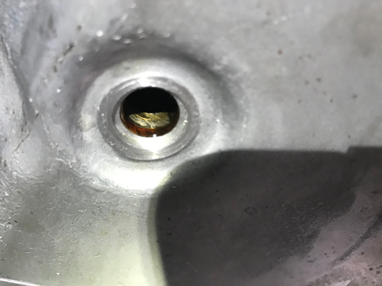

Hey guys I recently purchased a 2016 BMW M235i with 30,000 miles on it. I've owned it for about four months now, I purchased the car from a used car dealer in California and had it shipped down to Texas. When I received it I put it up on my ramps and noticed that the undercarriage cover had a lot of oil on it. So I then proceeded to remove the cover and degrease it and pressure wash it. I literally used a whole gallon of degreaser to try and get out all the oil that was in embedded into the fibers of the cover. I then let it dry overnight and reinstalled it, this was a few months back when I did this. Since the time of me owning it I haven't done an oil change on it and have only put 2000 miles on the vehicle so far.
So this week I decided I was going to do the oil change and purchased the OEM BMW 0W-30 oil change kit from FCP euro. This morning I decided to do the oil change. While removing the oil drain plug I noticed there was some resistance at around the halfway mark removing the bolt it wasn't much so I didn't think much about it at first. I let the oil drain for about an hour and then proceeded to put the new crush washer on the drain plug and replace it back on the oil pan. I threaded it in by hand like I always do on all y vehicle and then proceeded to tighten it down with a 17 mm socket and a 3/8" ratchet. Once again at around the halfway mark I noticed some resistance it wasn't much and after a turn or two it went back to feeling normal so I proceeded to tighten down the drain plug once it was seated with the oil pan. I the noticed it wouldn't stop spinning and I was never able to torque it down to the 25nm. I then realized that whoever had done the oil change last cross threaded the oil pan with the drain plug. I then decided to try and remove the plug so I could get a replacement and possibly try again, but I would not back out. I had to get a pair of vice grips and clamp it on the drain plug and put downward pressure while at the same time rotating it to back it out. I was finally able to get it out after about half an hour of trying. Once I got it out I noticed there were filings from the oil pan on the drain plug. I then cleaned the threads of the oil pan and took a look at it from directory under with a flashlight and saw that the threads were damaged. I went to BMW to pick up a new drain plug and an oversized drain plug that the parts guy said they also had in stock, which he stated the BMW technicians use when this happens. I got the exact measurements of the OEM plug and found that it was a M12x1.5 and the oversized plug I also purchased from BMW was a M14x1.5. After some research on the issue I decided to get a tap in the OEM size of M12x1.5 and proceeded to try and clean up the threads on the oil pan instead of retapping it to the larger drain plug's size. I used some grease on the taps channels to catch the shavings. After going back an forth a few times and cleaning and re greasing the tap I was able to clean up the threads and use the new OEM drain plug with the new crush washer after confirming it would go in and out by hand several times. I then lightly tightened it down by hand because I didn't want to attempt to torque it down to specs and possibly cause it to cross thread again. I did get a cheap bottle of synthetic 5W-30 at a local auto parts store to test if it doesn't leak overnight and to flush out any filings that could be in the oil pan before putting in the OEM 0W-30 oil.
My question is do any of you know if the oil pan is under pressure during normal operation. If so at what psi, or is it not under any pressure when ? I am afraid that I might be driving one day and all the oil might come spewing out of the drain hole because the drain plug is not tightened down to specs. I was wondering if you all suggest I re tap the drain pan hole to the next size up which would be a M13x1.5 instead of the M14x1.5 that the dealer sold me. I am afraid that jumping from a M12x1.5 to a M14x1.5 might be too large of a jump and end up leaving me with little material to work with and possibly leading me to have to replace the entire oil pan. Which I was quoted $1800 to $2000 at my local BMW dealer today. I was also wondering if I should just put a few turns of Teflon tape on the drain plug threads and hand tightening it to create a better seal instead of considering re taping the oil pan to the next size up. I was considering removing the oil pan and taking it to a machine shop to have them repair it professionally. But after researching I found out that I would either have to drop the entire front suspension or pull the engine out to remove the oil pan and I am not ready to take on that kind of job. Any help would be greatly appreciated guys, sorry for the long post I just thought I should let you know the story behind the issue. I can get photos if needed of the oil pan drain hole tomorrow morning if needed.

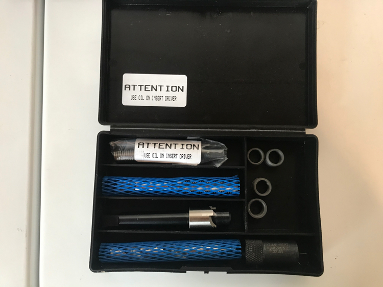

I did some more research last night and decided to purchase a time-sert kit in the M12x1.5 size which is the original drain plug dimensions.
This is the kit I ordered in case anyone is interested or has the same issue.
https://www.amazon.com/gp/aw/d/B003S...UTF8&psc=1
Along with their version of thread locker.
https://www.amazon.com/gp/aw/d/B00IZ...b_b_prod_image

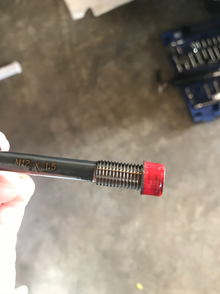

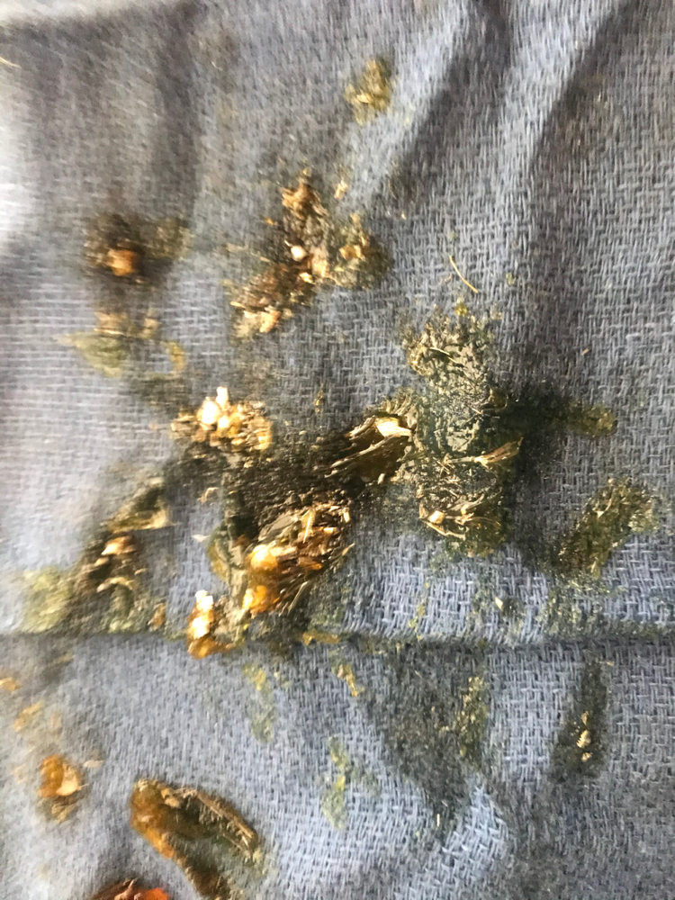

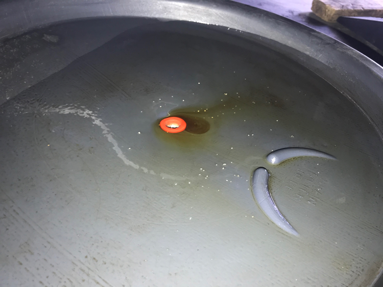

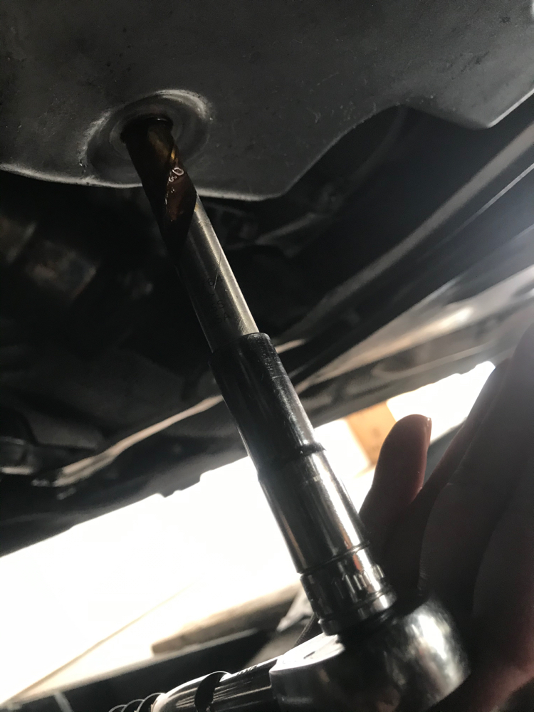

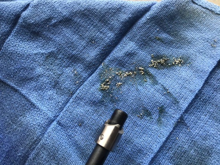

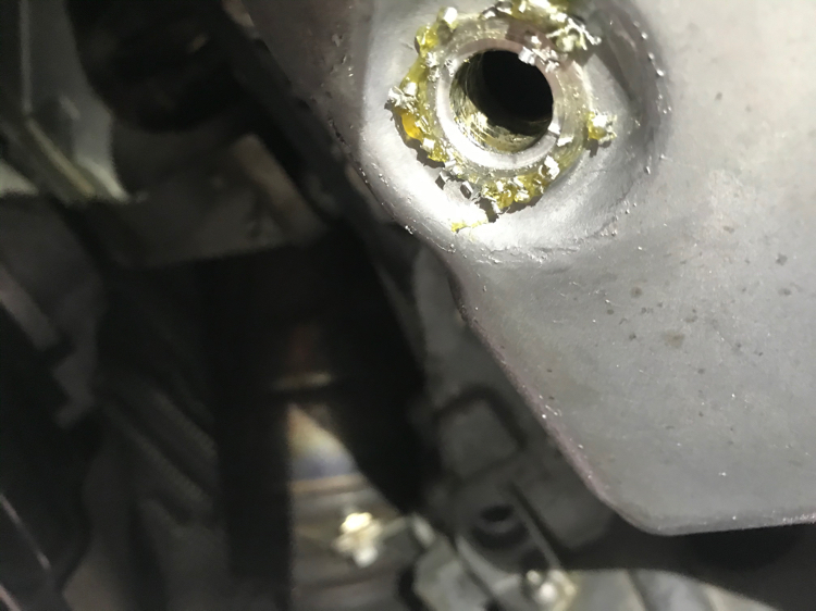

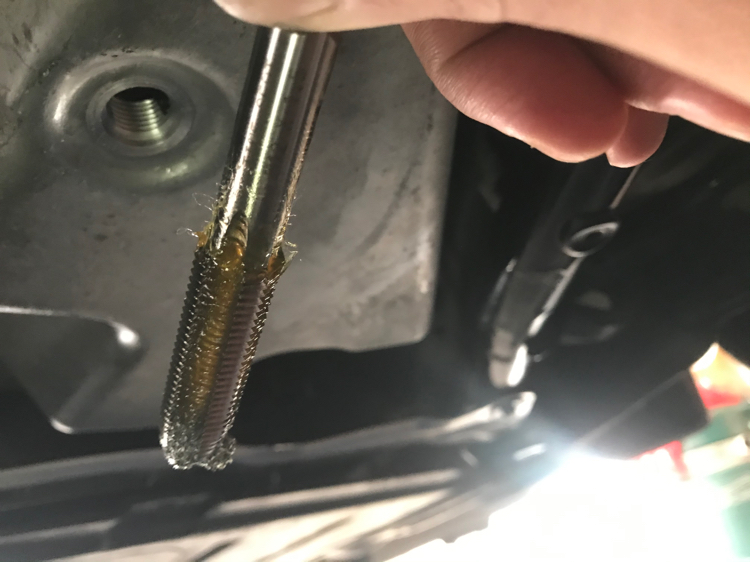

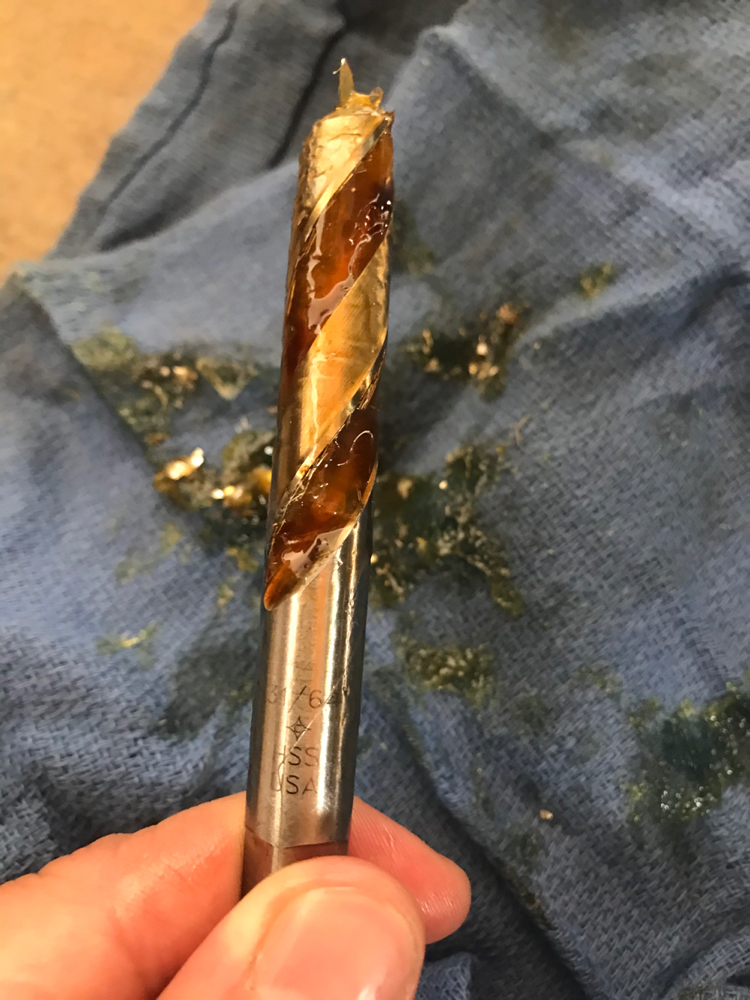

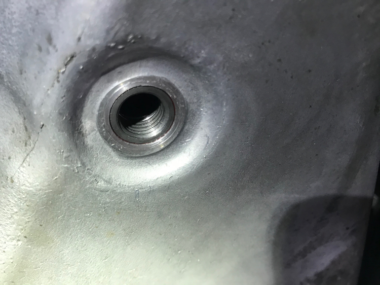

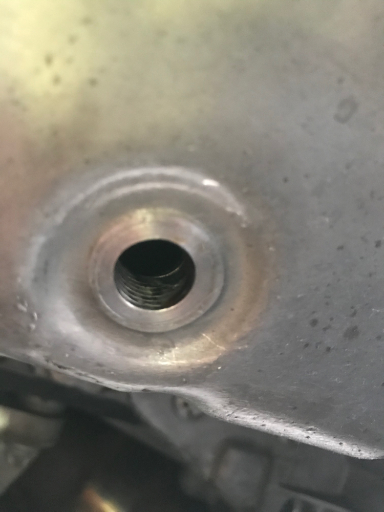

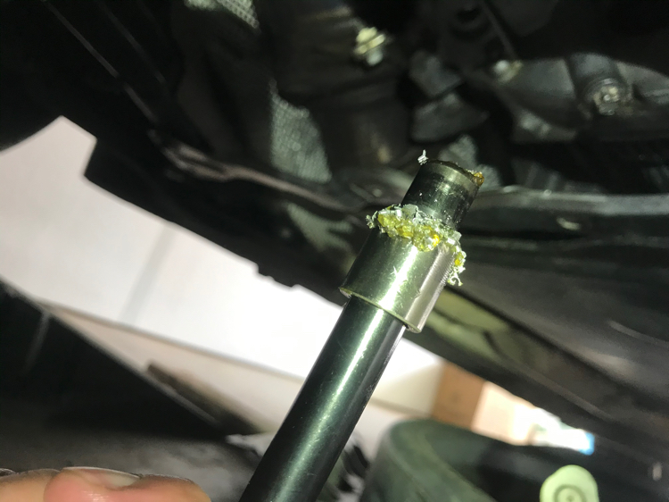

So I received the time-sert today from amazon in the size M12x1.5 along with their 500 degree thread locker/sealer. I'm going to list the tools I used to do the job below as well as photos of the process in case anyone needs to perform this job on their F-series N55. But the same process can be used on most BMW models old or new.
Tools/fluids used:
3/8" ratchet
11 mm 12 point deep socket
3/8" 12 point deep socket
Tap T-handle
Can of brake cleaner
Automotive lithium grease
2 to 3 quarts of cheap 5W-30 synthetic oil to flush
Time-sert 500 degree thread locker/sealer
Blue shop towels
Clear safety glasses
123Britt329.50
      07-22-2020, 11:57 PM   #12
DannyM235
DannyM235's Avatar
59
162
Drives: BMW F22 M235i
Join Date: Feb 2019
Location: El Paso, TX

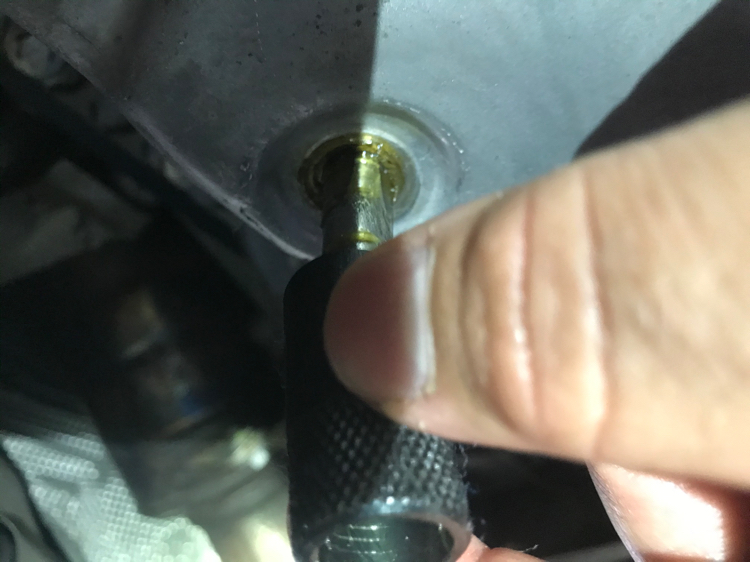

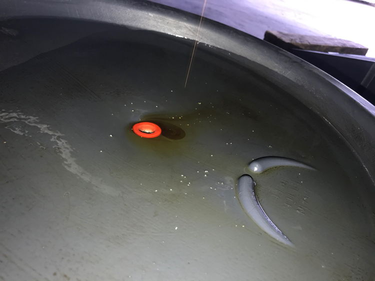

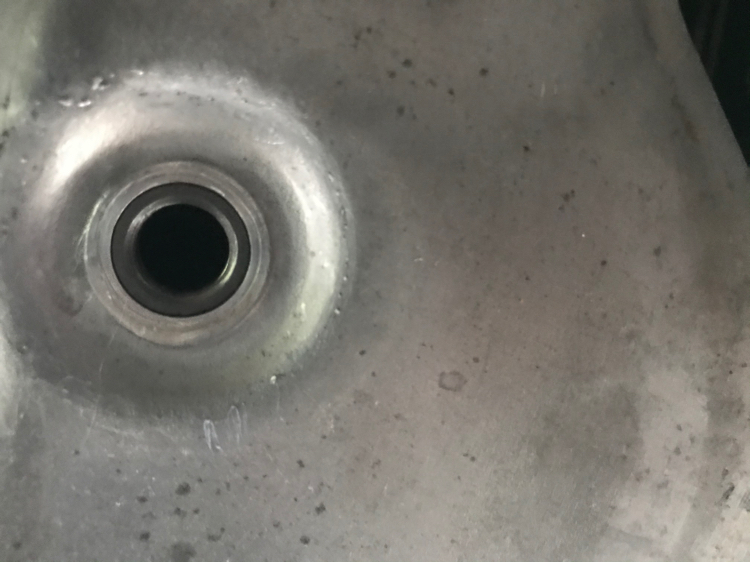

Here are the rest of the photos from the job. Total time was around 1 to 1.5 hours because I took my time and went slow to ensure I wouldn't mess up. In the end the total cost for me was around $200 because earlier in the week I went out and bought a M12x1.5 tap and t-handle from Northern Tool to chase the original threads. But I didn't like the wobbly feel of the new OEM drain plug after chasing the threads, so I went with the time-sert option, which was a tenth of the price I was quoted at BMW to replace the oil pan. I'm letting the thread locker/ sealer dry over night then I'll be flushing two quarts of cheap synthetic 5W-30 to get out any filings in oil pan. After that I put in the new OEM drain plug and torque it down to 25 nm and put in the OEM BMW 0W-30 oil. After driving it for about 100 miles I'm going to change out the oil filter again to see if it picked up any filing shards. Before doing the install I let the oil pan drain for 3 days while I waited for the time-sert to come in to ensure there was very little oil during the install. Hope this small write up helps others out with the same situation. My advice is take it slow and don't rush the job so you don't ruin your oil pan.

Finally got the oil change done today along with the spark plugs and the fixing bow on the exhaust valve because I had rattling. Anyways back on topic, I let the time-sert with the thread locker dry for almost 48 hours. I started by flushing 2 quarts of cheap 5W-30 synthetic oil in. I let the quarts warm up outside for a few hours before I put them in. I then let it sit for about 30 mins and to test the time sert, after letting it sit and seeing everything was fine I then flushed it. There were filings in the pan, it wasn't much though. I then torqued the drain plug to 20 nm instead of 25 nm and filled it with 6.5L of BMW 0W-30. Here are the photos of the filing that were in the oil pan. Just wanted to let those who are interested know that, you should definitely flush it out after installing the time-sert.
