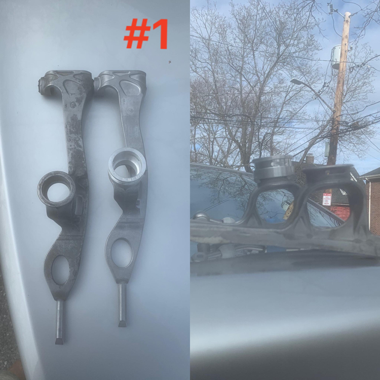

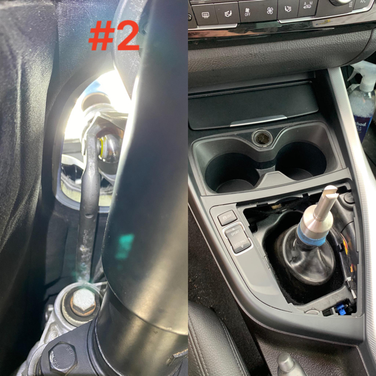

Over the weekend I installed a Rogue Engineering short shifter kit in my 6spd M235i.

TLDR: I made a Rogue Engineering F87 M2 short shifter work on my F22 M235i. Most people don't have access or the ability to tig weld aluminum, so Rogue will make a batch for F2X if there is enough interest.
The oem shifter in F2x is decent from the factory compared to most modern manual cars, but like most things, it could use a little improvement.

Out of partial ignorance and partial hope I ordered the f87 shifter. This weekend when I took my car apart I realized what I had hoped wouldn't be true, was true. The f87 carrier and the f2x carrier are different. (see pic #1 below). The two are different lengths and have different mounting points on the trans and the chassis.
I was so determined to have this shifter in my m235i that that I ended up cutting my oem carrier and the brand new carrier supplied by Rogue and morphing them into one.
This involved tig welding Rogue's raised pivot cup onto the f2x carrier so that the bottom of Rogue's shift lever would line up with the f2x selector rod. (see pic #2 below)
I was thrilled and relieved that it worked, and I was able to install the rest of the shifter.
I was also happy to find out that my M235i now feels just as good as my e36. Shorter throws, no more side to side movement, no more rubbery feel, and no added NVH!

I definitely know what he means. Most short shifters might shorten the throw, but at the same time they compromise feel.
My favorite part about the Rogue kit is the improvement in feel. It feels like how BMW should make the shifters feel in performance cars. The shorter throw is just a bonus.
It took me about 5 hours on jack stands. This was my first time fully tearing apart the underside and the shifter of a newer Bmw. My second time it would probably take me 3-4 hours.
I'm guessing a good Bmw shop that knows all the tricks already could get it done in 2-4.
