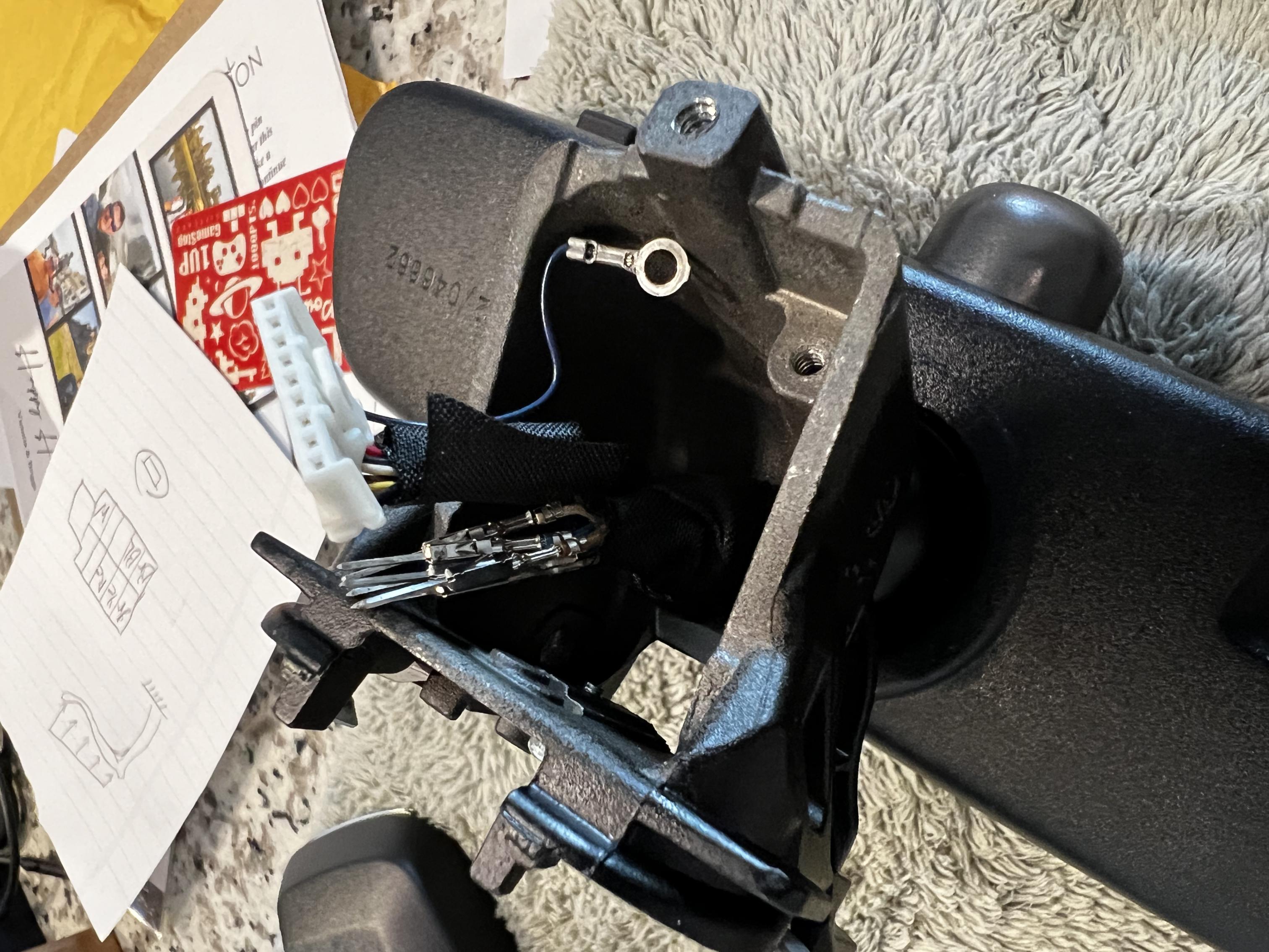

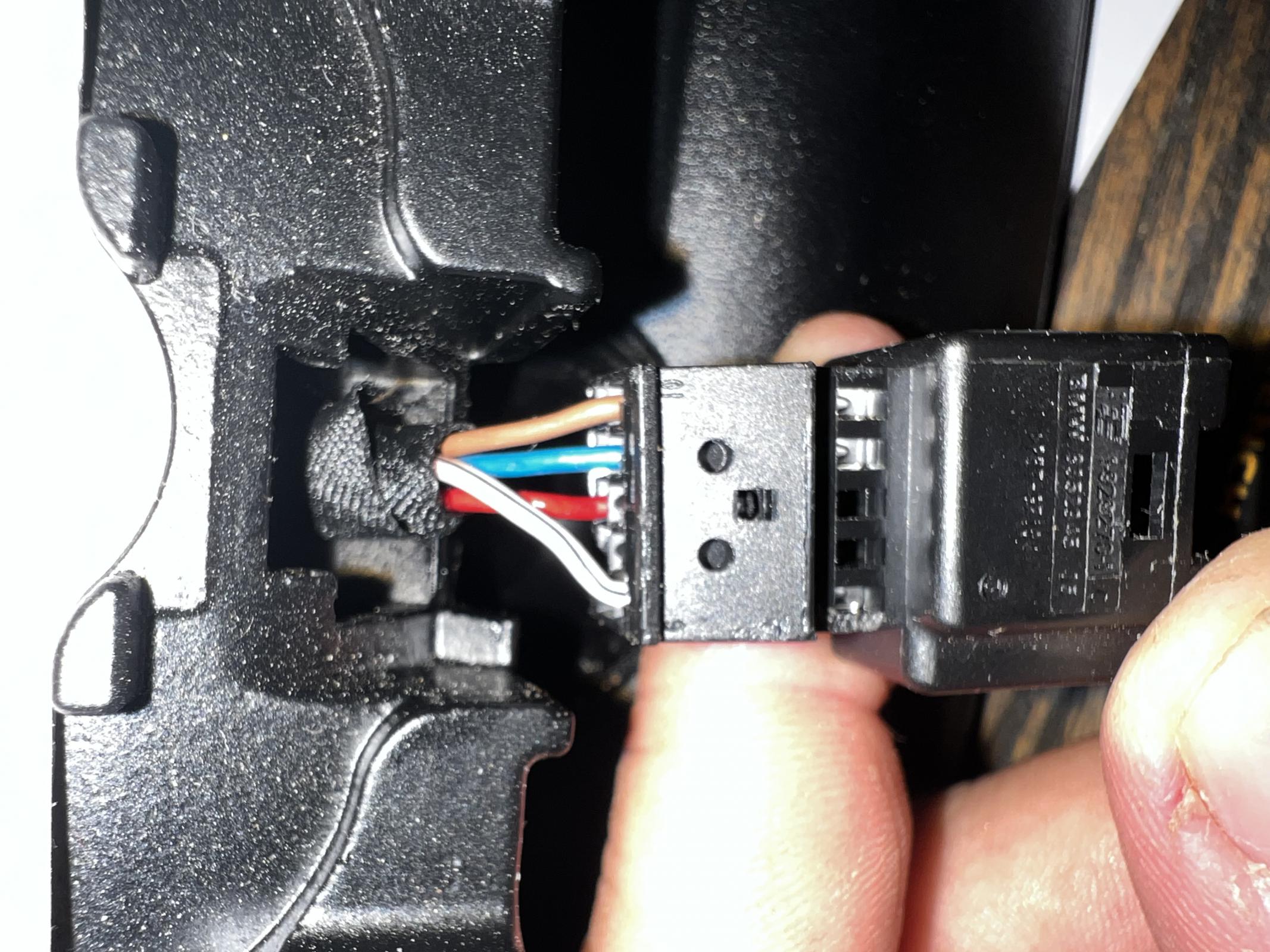

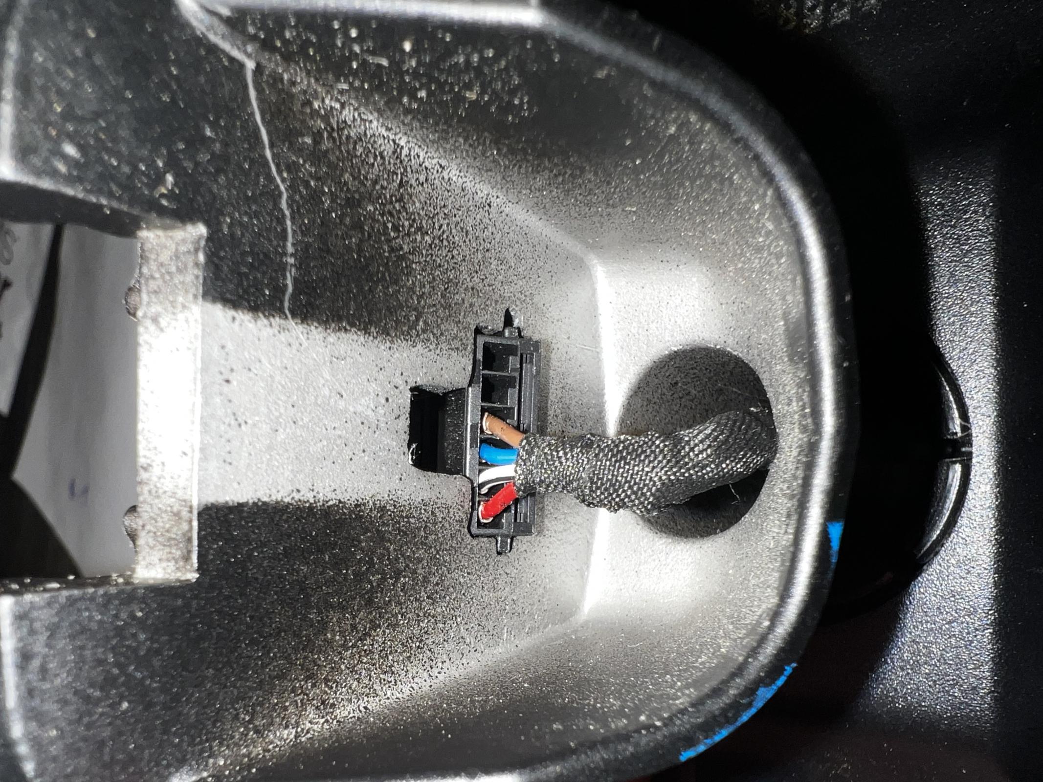

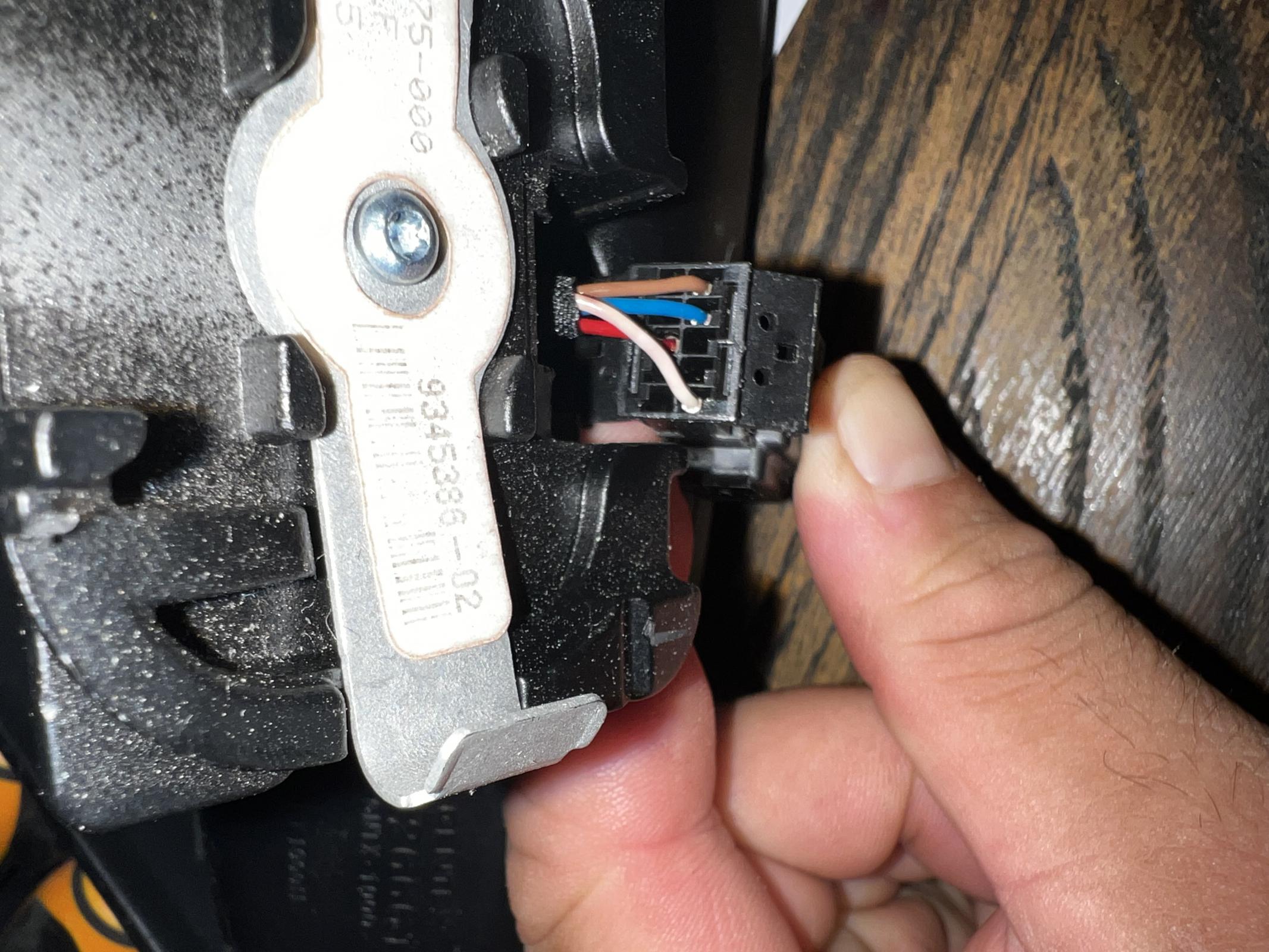

After pulling the mirror from your car, note the pin locations in the 2 series mirror plug, and the color wires for each pin:

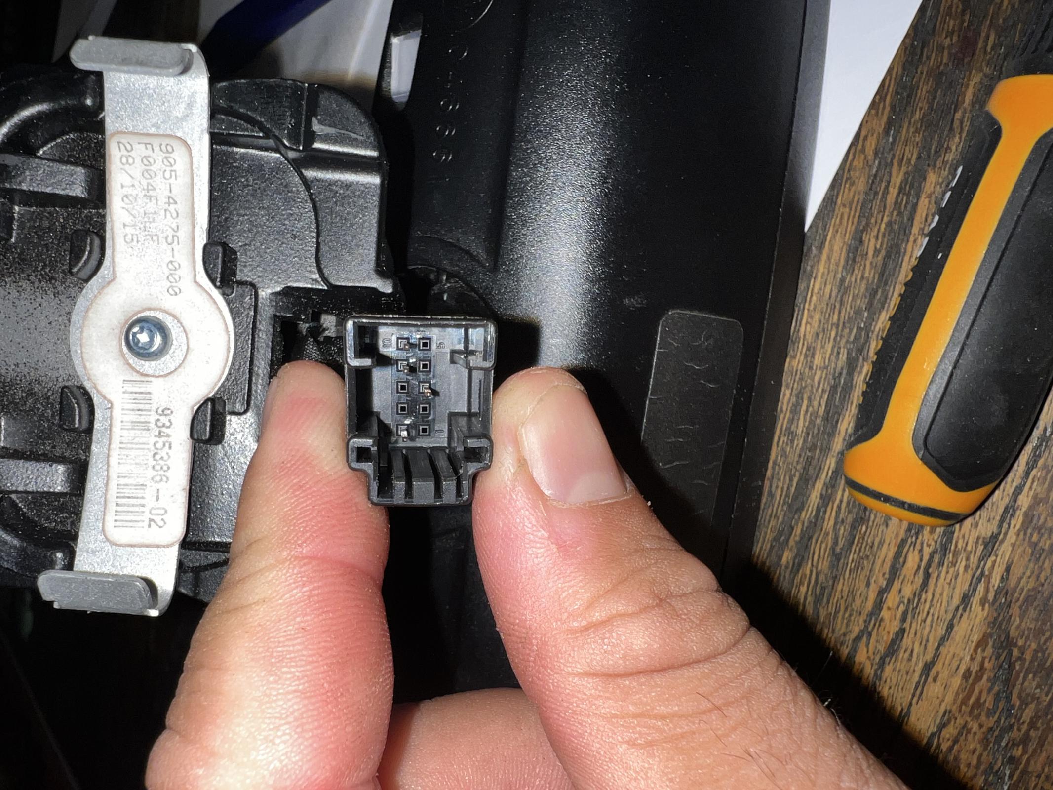

The upgraded mirror has the same four wire colors, but in a different shaped plug:

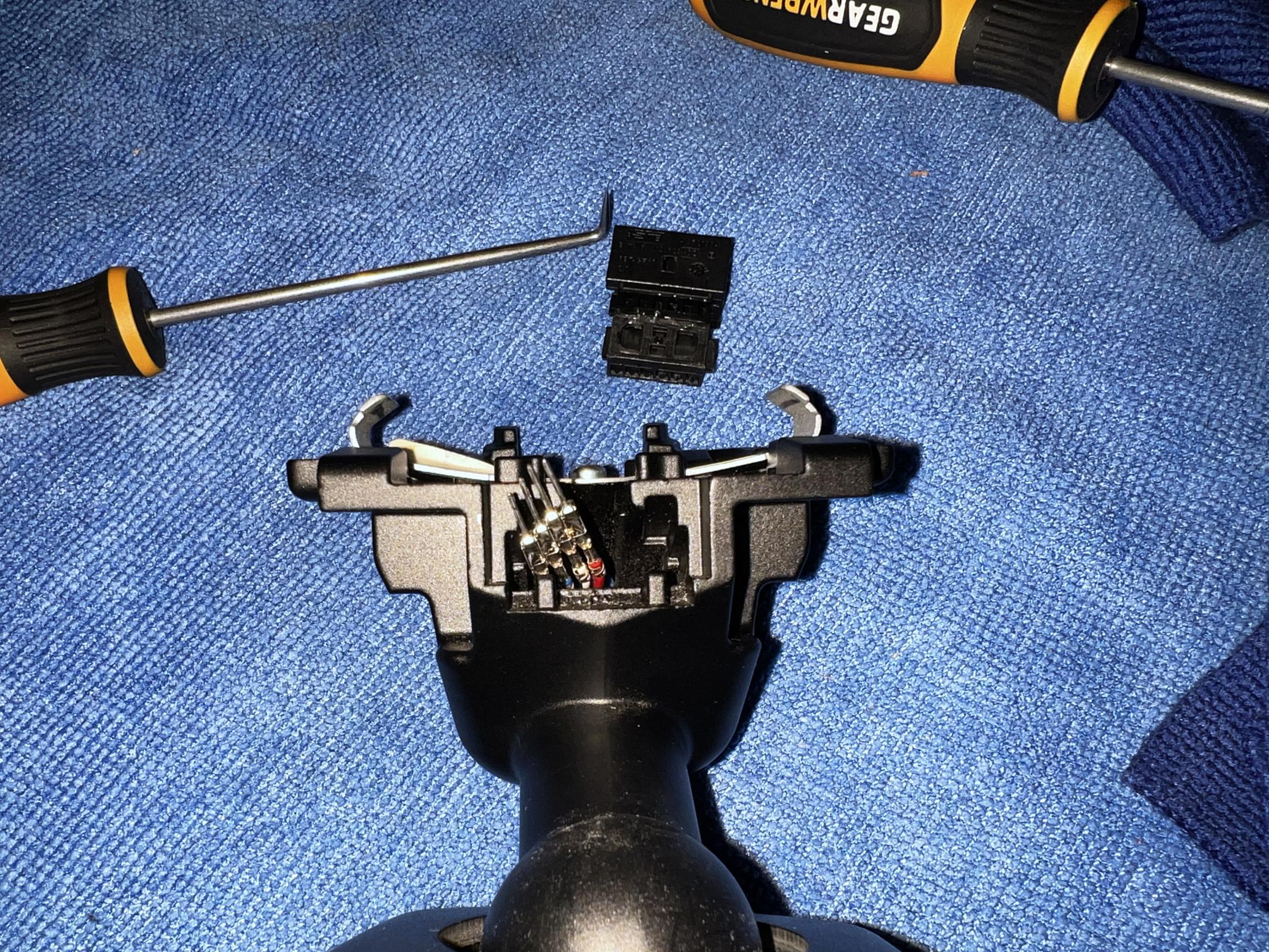

Use a pick tool to pop out the clips on both plugs, and then pop out the pins from both plugs:

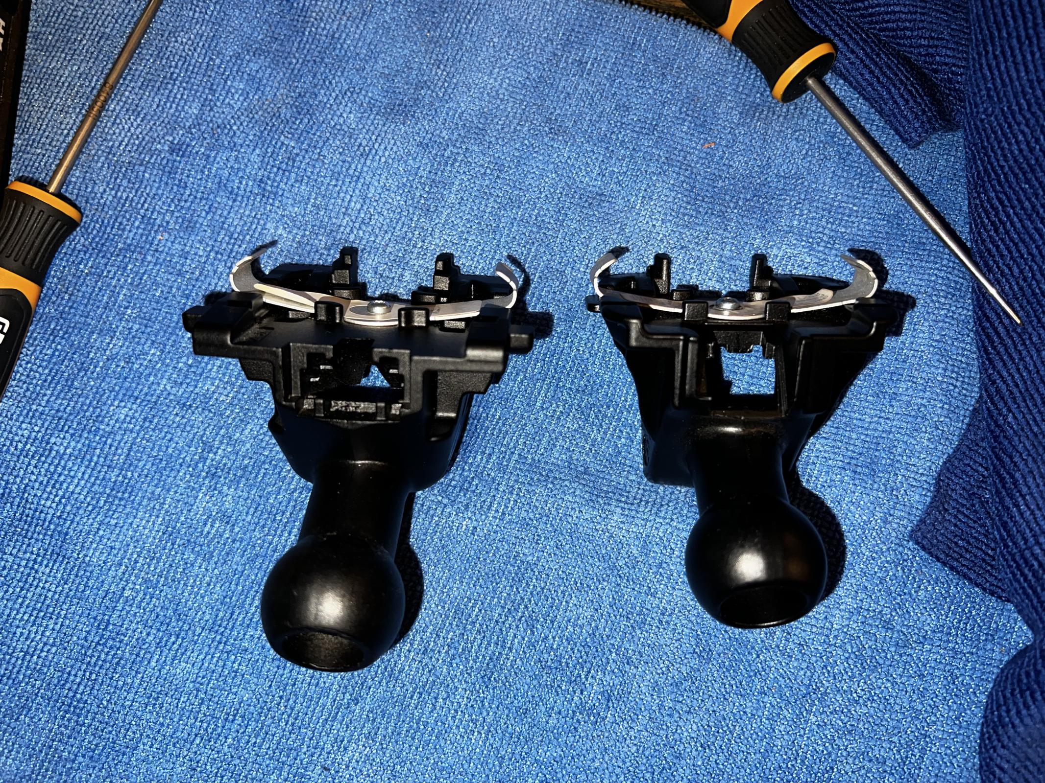

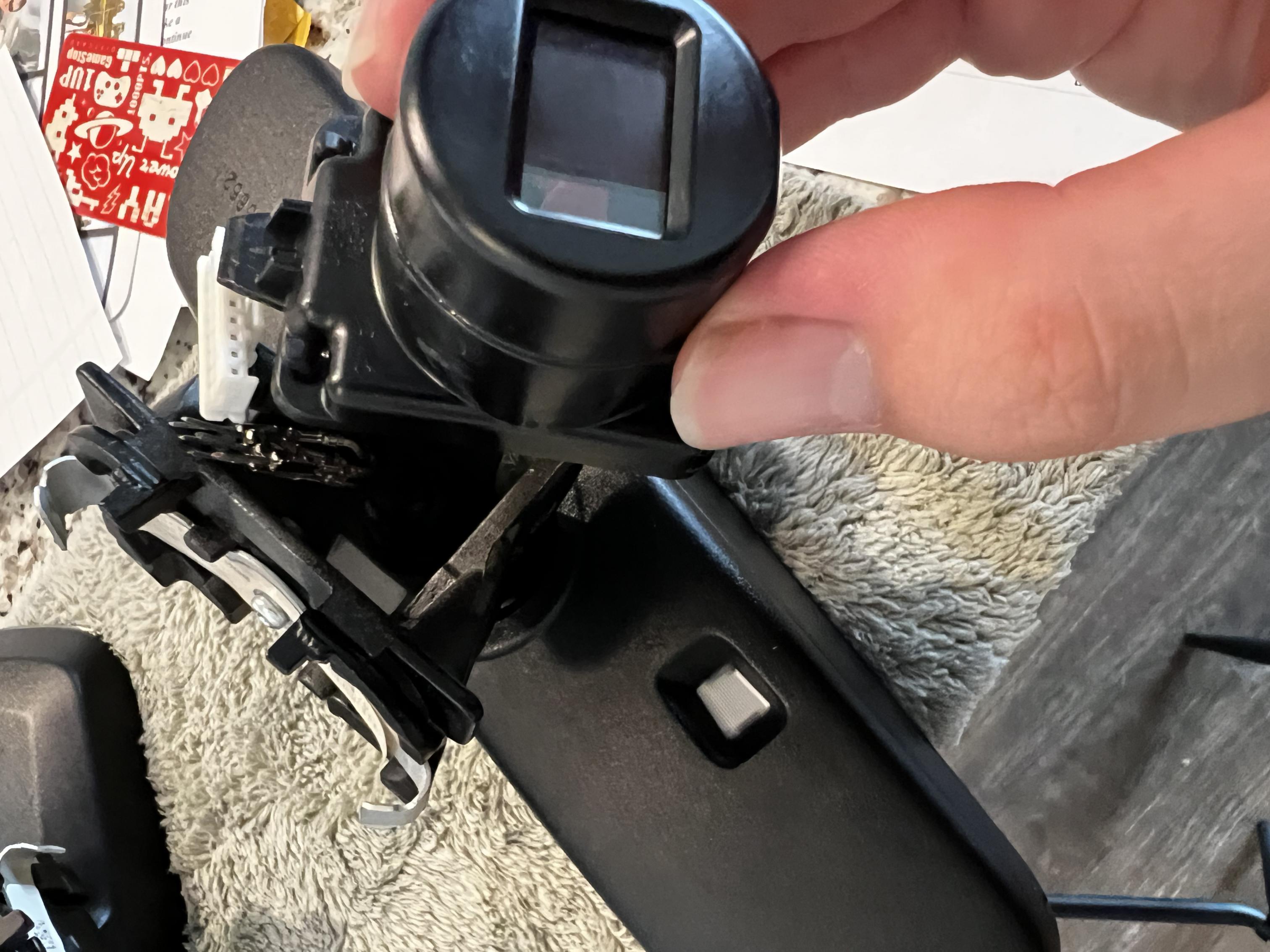

Then comes the hard part, removing the ball joint from each mirror. Follow the YouTube video's instructions for this. Lay a towel on a flat hard surface, and put a second towel over the mirror mount. I braced the mirror against the table with one hand and pressed the mount to one side while twisting it, to pop it out. It's a very nerve racking process because you feel more certain every second that the mirror will break.
The two mounts have different shapes and sizes, so you must swap them.

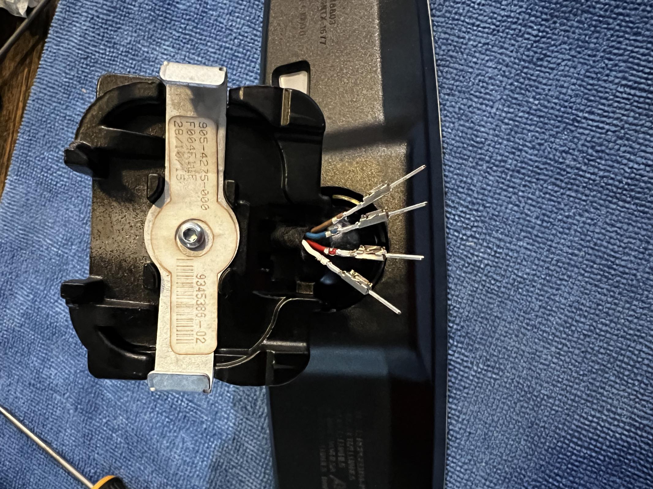

Now the hardest part: attaching the 2 series ball joint to the new mirror. Again lay the mirror face down on a towel on a hard surface. Thread the wire harness and pins through the hole in the mount. I applied a little bit of grease to the ball joint, but I don't think the grease really did anything. It will take a LOT of force to get the ball in. I'm almost 200 lbs, and I leaned into the mount as hard as I could. The ball went in with a loud BANG, and somehow, the mirror did not break.
After the mount is in, position the wires and pins like this, to line up with their positions in the 2series plug:
Use the pictures I posted above to make sure the pins are inserted in the same positions as the old mirror wires.

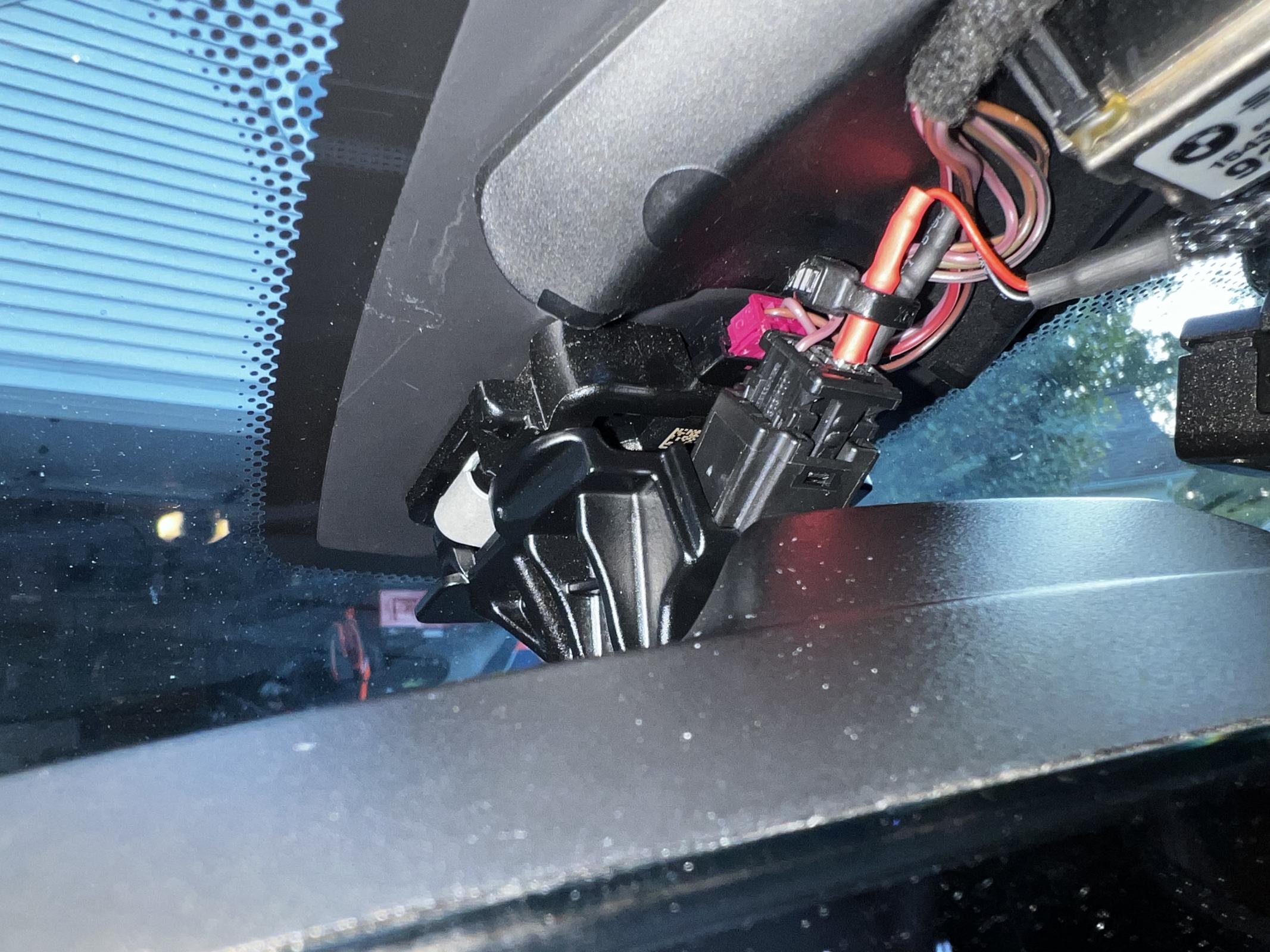

After this, slide the mirror back into the windshield bracket and reattach the harness plug:

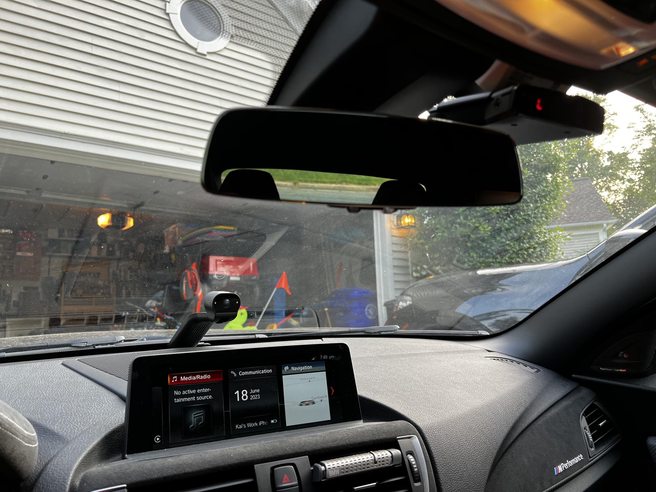

Pop the cover halves back on, and you're done. Finished result:
The new mirror looks much sleeker and seems to have more visibility at each side.
