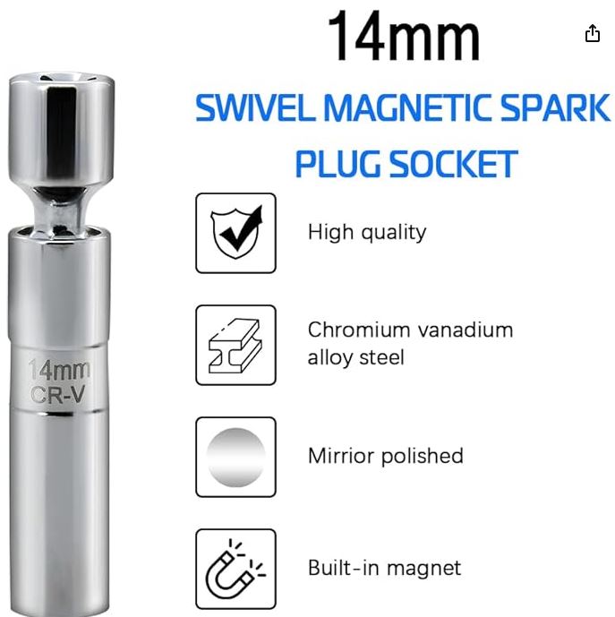

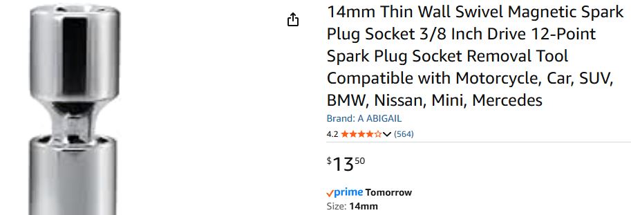

came across this on amazon
Attachment 3782041
Attachment 3782042
Yes that will work.

it came and didnt fit !
I bought the plugs from a dealer, and due to the magnet inside, the insulator whould not fit
In the small print from amazon it says "fits most BMW's" grrr

The socket with the magnet works it just does not grab the entire plug properly.
Unless that brand is different.
You dont actually need a magnet swivel socket.
14mm 12point thin wall socket is perfect.
nazali1739.50

hi txs,
the actual magnet made the hole smaller, it wouldnt fit over the sparkplug
I looked at another one and it had the internal measurements so I'm trying that one next
I heard due to angle you really need a swivel socket ?
BMW documentation says to use one to save from breaking the plug
