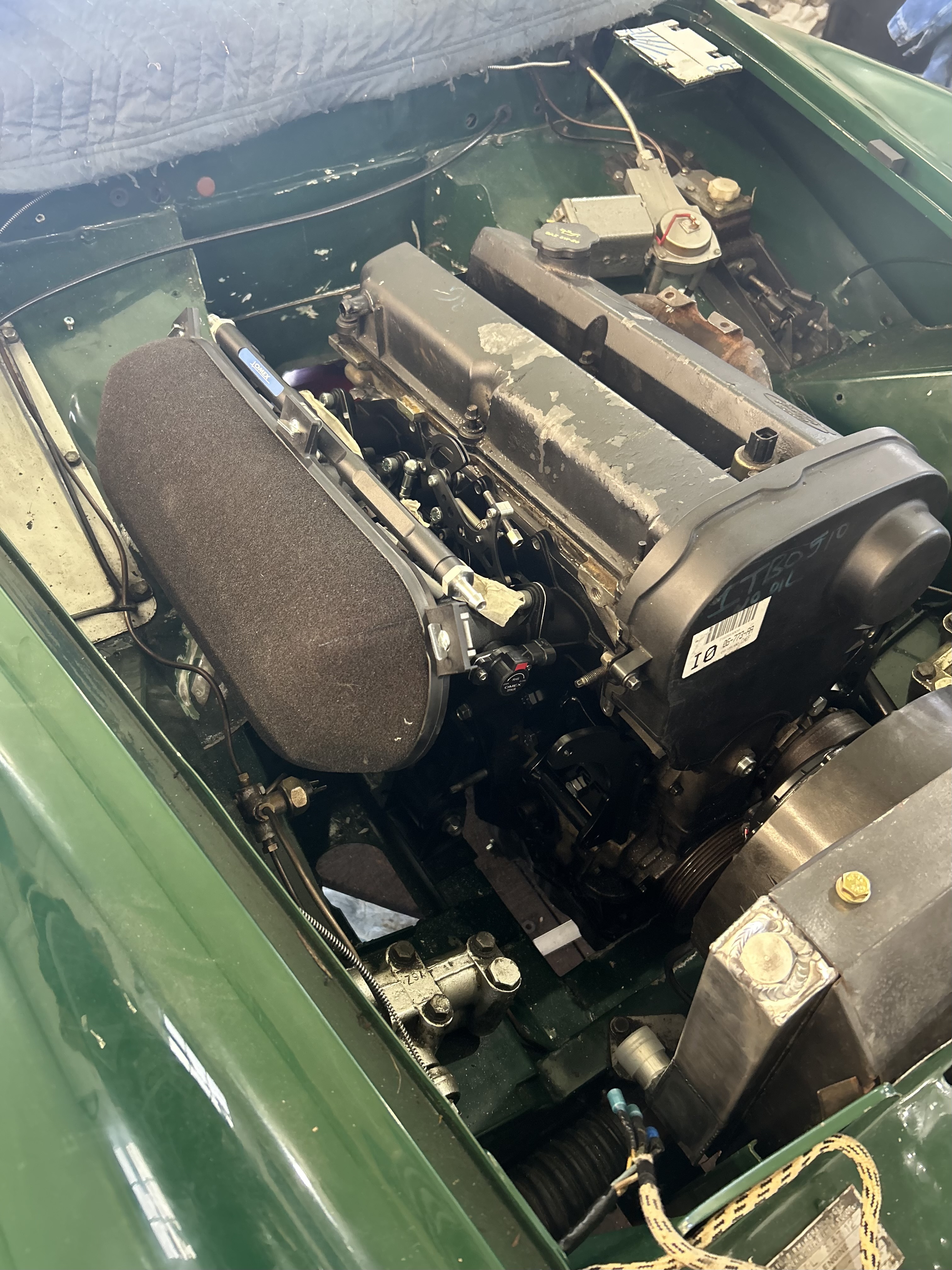

For those that don’t require originality, Zetecs and Duratecs turn Little British Cars into pocket rockets.
