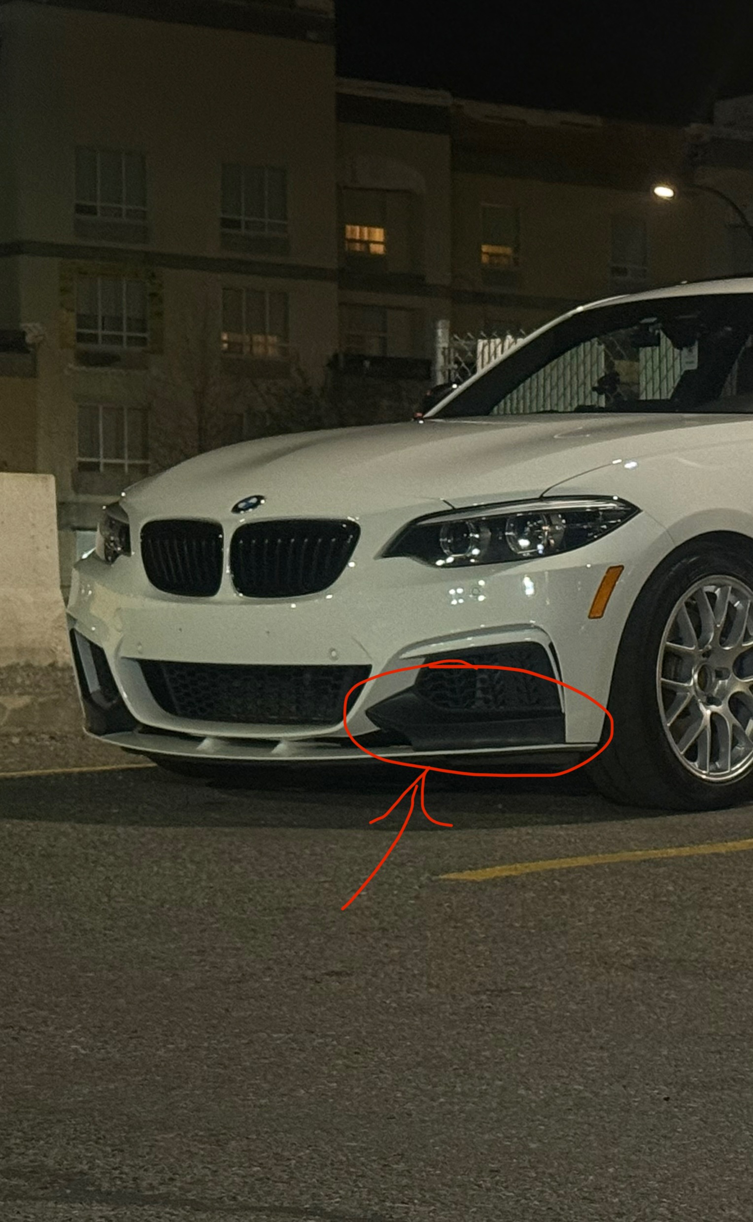

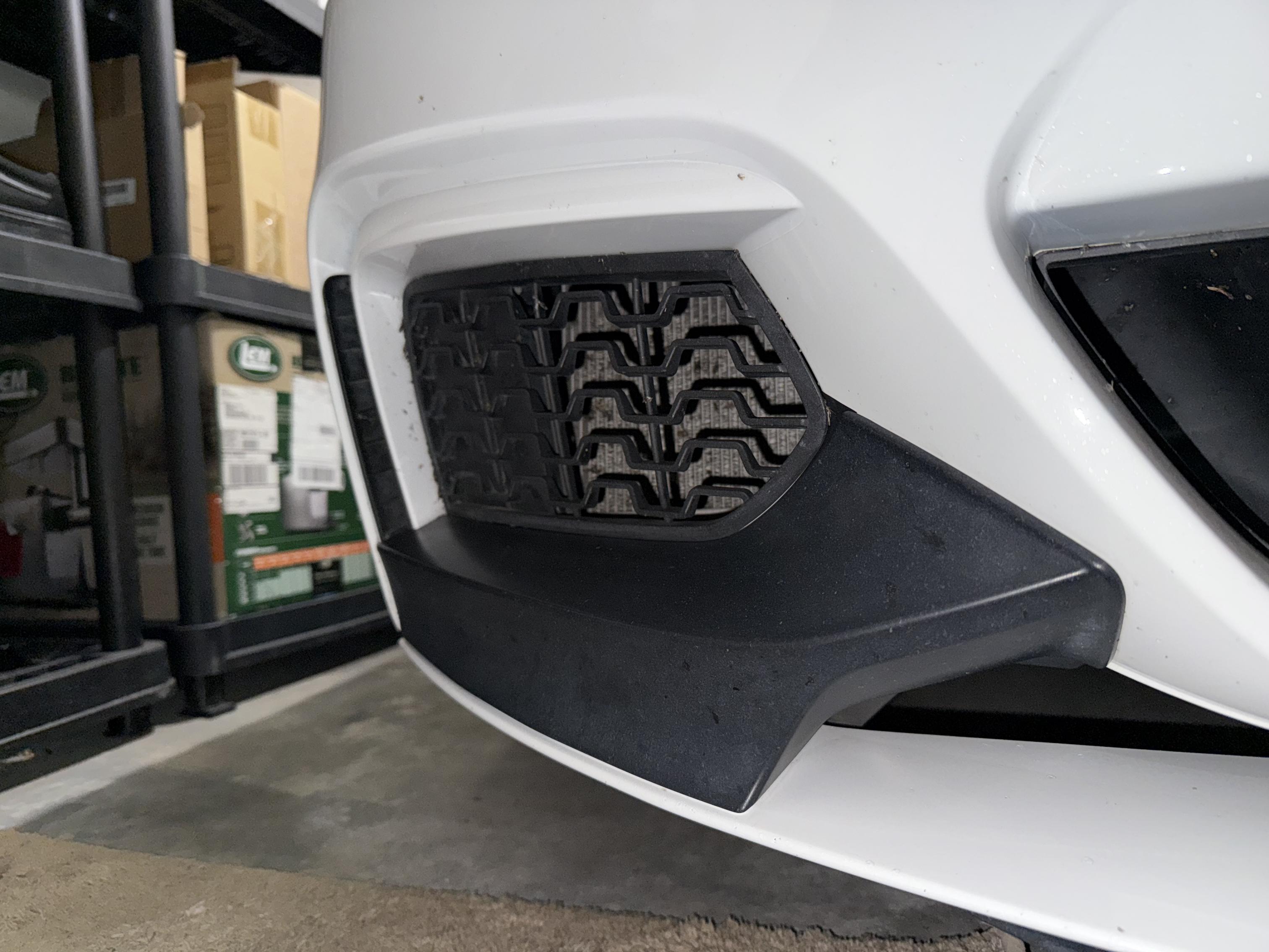

Hi all,
Has anyone removed the plastic splitters on top of the M-sport front bumper with the lip attached? I am not sure whether the lip must be removed and if the splitters are bolted, put together with clips or just glued on with double-sided tape.
I have bought a replacement carbon splitter that I’d like to replace with the stock matte-black splitter.

If it was done professionally they used betalink adhesive. It's known as a real pain in the A to take off.
If there's screws to remove, you could see/feel from underneath.
Just my opinion, the car looks good as it is. But you do you.

The matte black looks so good.

Check for screws under the lip,use fishing line behind the splitter and cut out the adhesive/2way tape.
