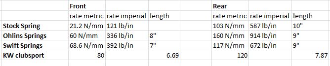

Ohlins provide a 16kg rear spring which made the car not very nice to drive on the road in my opinion.
I went with a 12kgs swift spring on the rear and 7kg on the front.
This is some spring info I put together.
Thanks! I'll keep this in mind if I move forward with it.
