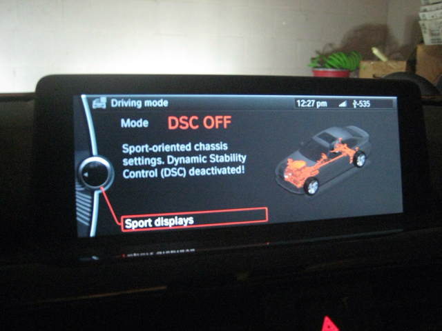

When you hold the DSC button the iDrive screen shows sports oriented chasis... and the steering is like in sport mode... i haven't been able to test if there is any difference in damper feeling...

in my case with DSC off the steering (and i guess suspension is set together) still stays in sport mode and it even says so in the idrive screen when you switch DSC off... you do lose the sharper throttle mapping though
Active sound is the enhanced engine sound that is played through the speakers when in sport mode... do this with the car parked accelerate to 2000 rpm and go from comfort to sport and vice versa, you will hear the difference right away

Nothing - only the center (below the clocks) display goes off (from Sport or Sport+), which indicates Normal mode.
I think if you go to settings - configure sport. There is a drive mode check box if you have it on you can see a detailed description on the idrive when you switch modes

Firstly, there can be some differences between F22 and F10.
Secondly, the screen above (showing for several seconds each time you change the mode) can be activated or deactivated in iDrive; of course I have it permanently off as my driving is not about watching pretty pictures (the same each time I go into a given mode); suppose I'm actively using navigation - such a picture can obscure the map for too long - with my usual speeds may mean a lot of extra miles if I miss my exit.
So, I have set my iDrive to never show the graphics, I only rely on the same information (albeit text only) in the extended functionality dashboard.
But most importantly, the graphics lies: yes - DSC is off; yes - it's *supposed* to be sport-oriented driving mode - but *NO* - chassis settings are Normal=Comfort.
